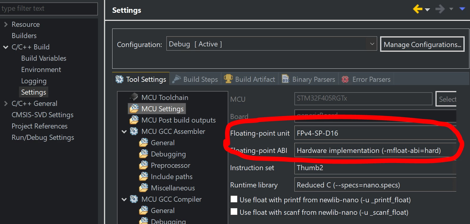

At compile-time, there are flags which are used to tell the compiler the chip has an FPU and to create hardware FPU instructions rather than software emulation. This is a compiler-time choice and not something that can be changed at run-time.
Enabling the FPU at run-time is also required, but is a separate step from this. In order to use hardware FPU, it needs to be compiled as such and the FPU needs to be enabled during startup.

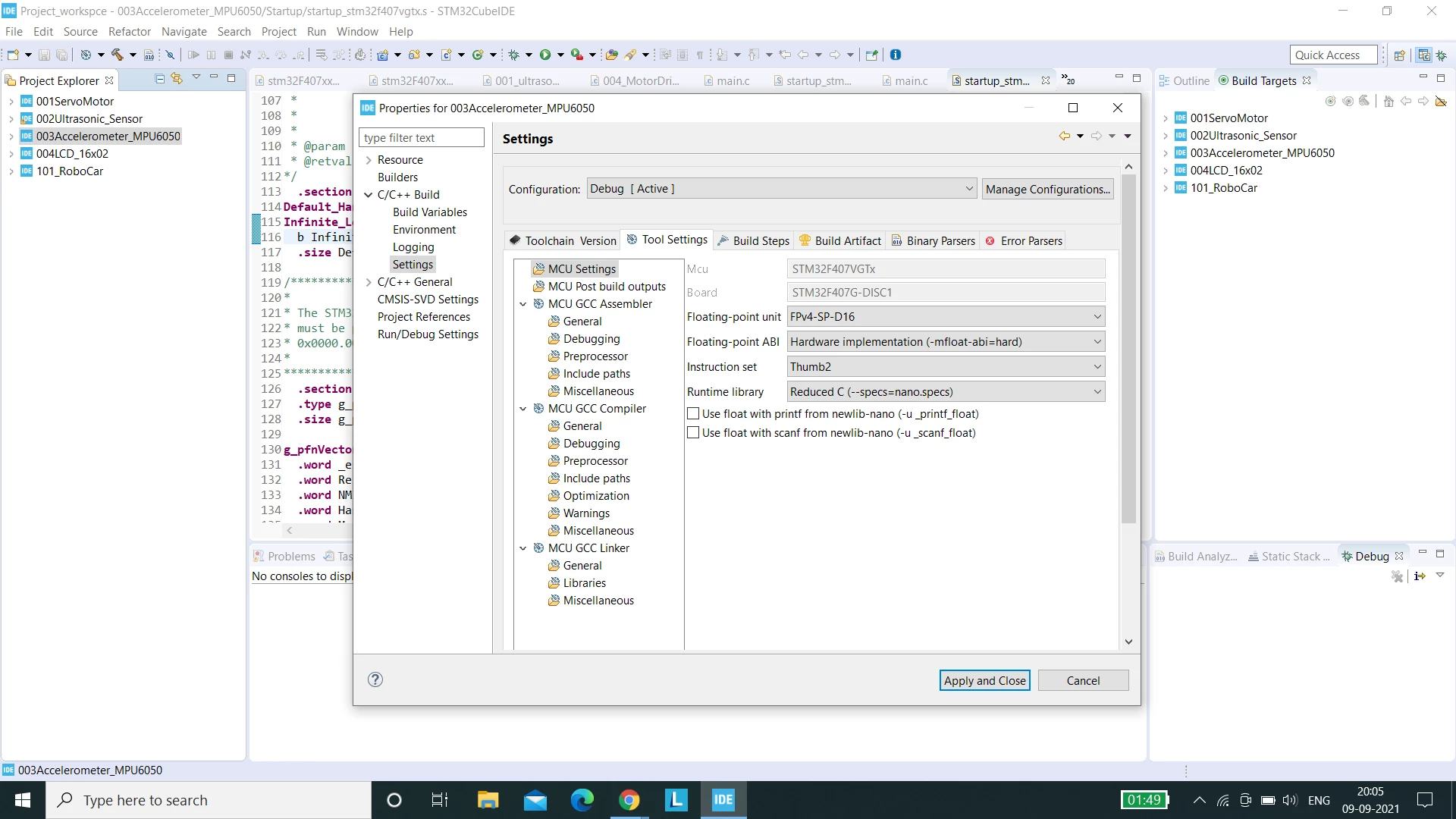

Thanks but ,
I have tried doing this but the result is same ,
(i have attacted some img for referance )

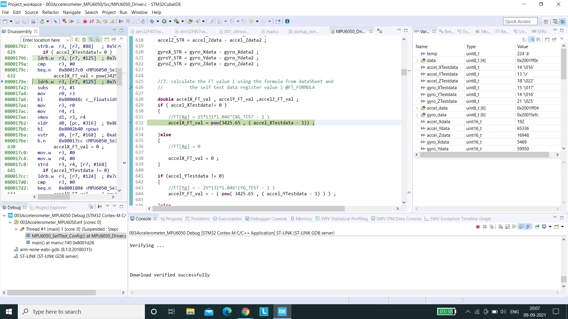

this is the first statement in my program here FPU calculation is required ( shown in above photo)
	double accelX_FT_val , accelY_FT_val ,accelZ_FT_val ;
	if ( accel_XTestdata!= 0 )
		//FT[Xg] = 25*131*1.046^(XG_TEST - 1 )
		accelX_FT_val = pow(3425.65 , ( accel_XTestdata - 1)) ;
	}else

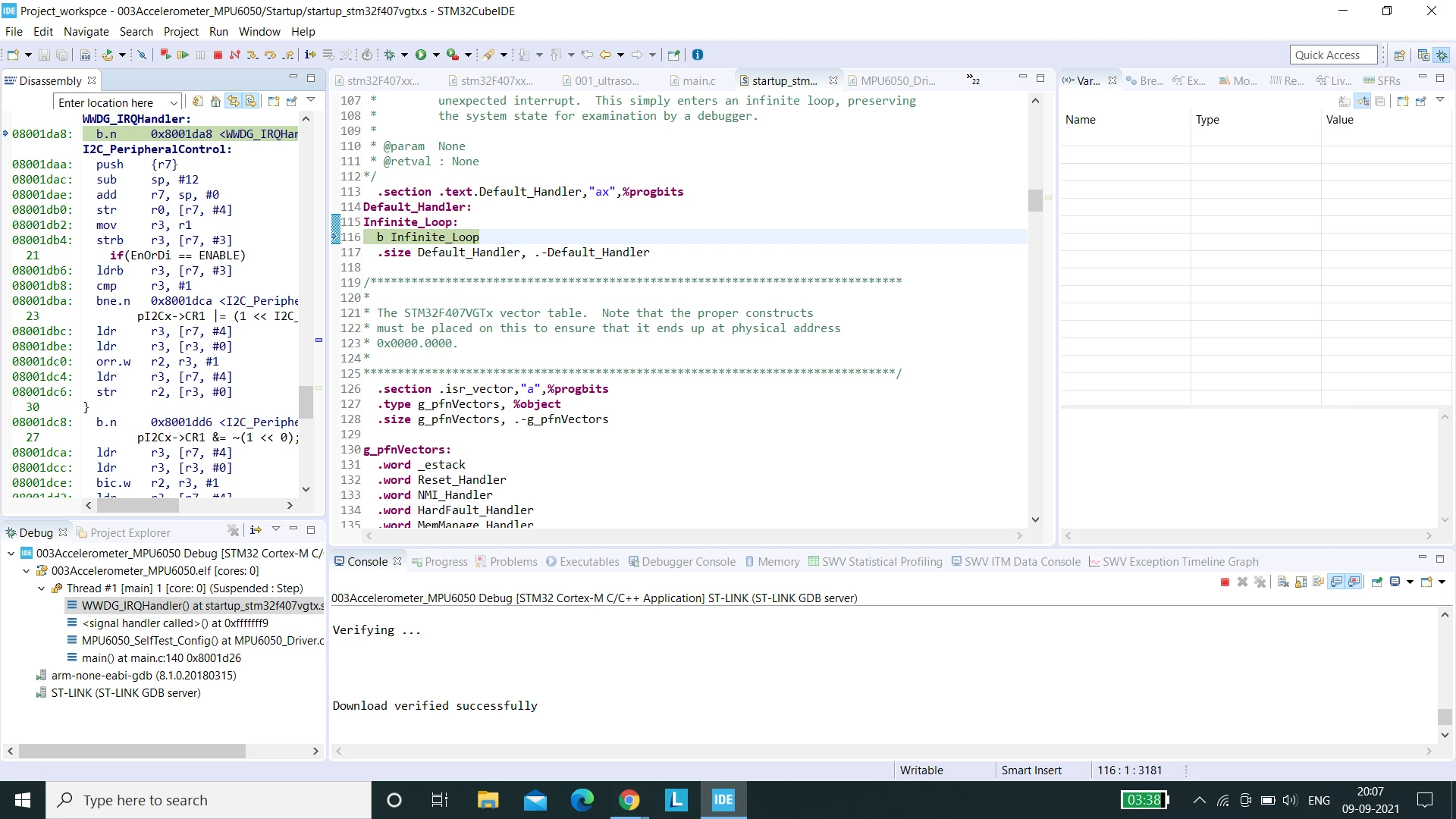

when this statement runs a hardware error occurs and program goes to infinite loop
Can you help with what i am missing

September 9, 2021
You're using the 64-bit "double" type, which is not supported by the FPU on the STM32F4. Only the 32-bit "float" is.
In the infinite loop, look at the value of the VECTACTIVE field in SCB_ICSR to see what interrupt the chip is in.

thanks,
I have changed variable from double to float
then also fault occurs,
As you said,
i have checked , VECTACTIVE field in SCB_ICSR  : VECTACTIVE - 0x3 { so it means hard fault occurs }
also i have checked , these bits :
SCB->CFSR-> FORCED - 0x1 (it is telling me hard fault is taken because of bus fault , usage fault , memory management fault )
SCB->CFSR->NOCP - 0x1 (it tells a attempt to execute coprocessor instruction )
also if have tried some other things
// i tried to run these instruction separately for testing purpose
accelX_FT_val = pow (2,5); // works fine
accelX_FT_val = pow(1 , ( accel_XTestdata - 1)) ;// works fine
accelX_FT_val = pow(1.046 , ( accel_XTestdata - 1)) ; // hard fault ouccrs
accelX_FT_val = 25*131*accelX_FT_val; // hard fault ouccrs
accelX_FT_val = pow(3425 , ( accel_XTestdata - 1)) ; // hard fault ouccrs
accelX_FT_val = pow(3425.65 , ( accel_XTestdata - 1)) ; // hard fault ouccrs
as this : accelX_FT_val = pow (2,5); // works fine  so math.h library has been added no problem in that case
accelX_FT_val = pow(1.046 , ( accel_XTestdata - 1)) ; // hard fault occurs  { as it is floating point calculation, could it be due to the reason FPU is disabled ??? }
accelX_FT_val = 25*131*accelX_FT_val; // hard fault ouccrs  ( if i calculated this explicitly result is 8.9245738115672328584839563027024e+45 )
accelX_FT_val = pow(3425 , ( accel_XTestdata - 1)) ; // hard fault ouccrs  ( if i calculate this explicitly result is 8.9245738115672328584839563027024e+45 )
In these two cases hard fault occurs due to over flow of variables ???

The FPU on the CM4F is single precision only, perhaps powf() ?
FPU typically needs to be enabled with code in SystemInit() or before
void SystemInit(void)
 /* FPU settings ------------------------------------------------------------*/
 #if (__FPU_PRESENT == 1) && (__FPU_USED == 1)
 SCB->CPACR |= ((3UL << 10*2)|(3UL << 11*2)); /* set CP10 and CP11 Full Access */
 #endif
