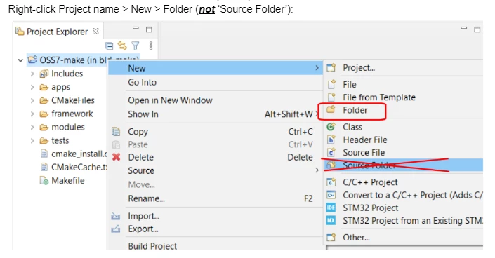

How to use common sources in multiple STM32Cube IDE projects
We have developped a set of recources - C en H files - which are used in many projects. How can we easily integrate these files in new and existing STM32Cube projects (CubeIDE version 1.8.0) and workspaces?
Andrew Neil
Andrew NeilBest answer
May 16, 2022 8:46 AM UTC
I would prefer to just copy them - then you get to choose when updates get merged into each project which uses them.
Otherwise, you might find that changes to the common code break your dependent projects at inconvenient times...
Version control systems such as Git or SVN allow you to do this.
But, if you really do want to do it, you can add a file as a "link":
This takes you to:

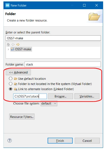

Choose 'Advanced>>'
Then choose ‘Link to alternate location’, and enter the path to your source files:

kris2399
kris2399Author
May 16, 2022 8:57 AM UTC
Thanks.
Seems like trying to include H-files from this common folder needs the full path specification in the C-file.(I tried to add the include path to the build settings, but this doesn't do the trick)
How do I instruct CubeIDE to also include the H-files from this added folder?
kris2399
kris2399Author
May 16, 2022 9:14 AM UTC
Sorry, please disregard previous comment: adding the path to the project does solve the issue.
