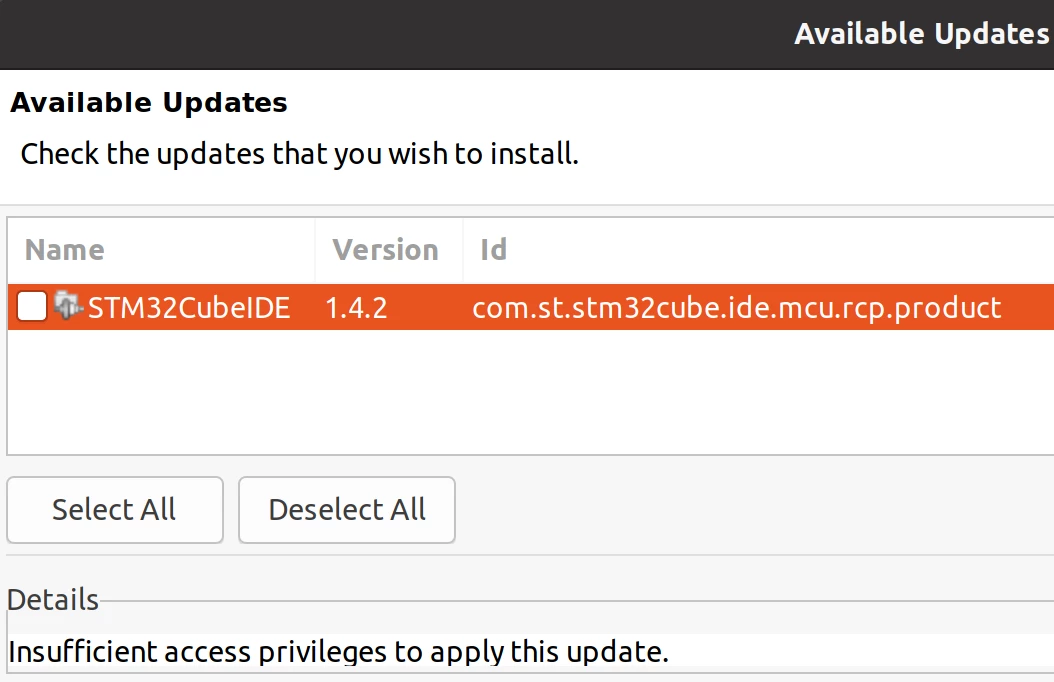

How to update STM32CubeIDE on Linux?
If I open "Help > Check for Updates", I encounter an "Insufficient access privileges to apply this update" error.
I installed by following this guide:
https://www.st.com/resource/en/user_manual/dm00603964-stm32cubeide-installation-guide-stmicroelectronics.pdf
And running the following command:
sudo sh st-stm32cubeide_1.4.0_7511_20200720_0928_amd64.deb_bundle.sh
I'm then able to launch the IDE from the OS GUI, just like any other app.
To update, do I need to launch STM32CubeIDE as root from CLI and then navigate to the update dialog?
sudo /opt/st/stm32cubeide_1.4.0/stm32cubeide
Or will that mess things up more?
If there are special update instructions for Linux, the guide should include those. A workaround is to re-download and re-install the IDE, but doing that for every update is not ideal. And in this case, there's no way to download 1.4.2. The latest available is still 1.4.0. https://www.st.com/en/development-tools/stm32cubeide.html

Hello Mf.1,
Unfortunately this is expected.
Since you've installed STM32CubeIDE using the Debian package, hence as root, you must have to run the application as root to unblock updates. Thing which is usually not advised in Linux world. Only installation of third-party features is supported by this kind of installation.
I'd suggest you to install it using the generic installer script st-stm32cubeide_1.4.0_7511_20200720_0928_amd64.sh. With this, the installation location will be owned by your uid, and updates will be possible.

Facing the same issue here. Again very disappointed that ST's official installation doesn't work as it should.
The workaround I followed was to change the /opt/st directory's owner to my user.
cd /opt
chown -R $USER:$USER st
