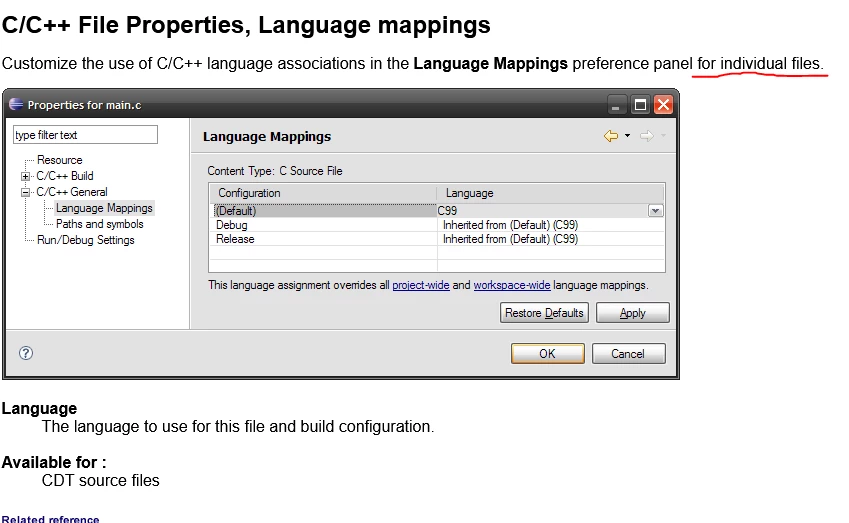

Andrew Neil
Dec 2, 2024 2:39 PM UTC
If you right-click the file and choose 'Properties', there's this:
Looks like generic Eclipse ?

unsigned_char_array
Lead III
Dec 3, 2024 8:55 AM UTC
You can exclude the c file from build and include it in a new cpp file. That's an ugly workaround.
@ferro wrote:
"Compiler options can be modified per file."
Where, how ?
Rightclick the file. Click properties. Click C/C++ General. Click Language mappings. Then select GNU C++ from the drop down menus.

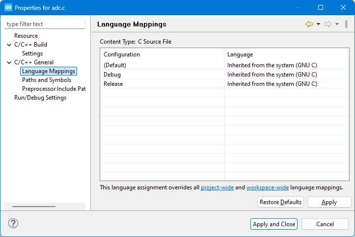

unsigned_char_array
Lead III
Dec 4, 2024 8:18 AM UTC
And what happened? Can you show your build log?
"Kudo posts if you have the same problem and kudo replies if the solution works.Click ""Accept as Solution"" if a reply solved your problem. If no solution was posted please answer with your own."
ferro
ferroAuthor
Lead
Dec 5, 2024 1:34 PM UTC
Here, the original C recipe is used despite setting C++ in mapping.
I''ll come back later with a document describing what is going on.
