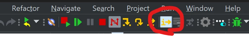

Enable instruction stepping mode by clicking this icon.
Use normal step into/over commands to step into/over individual assembly instructions.
