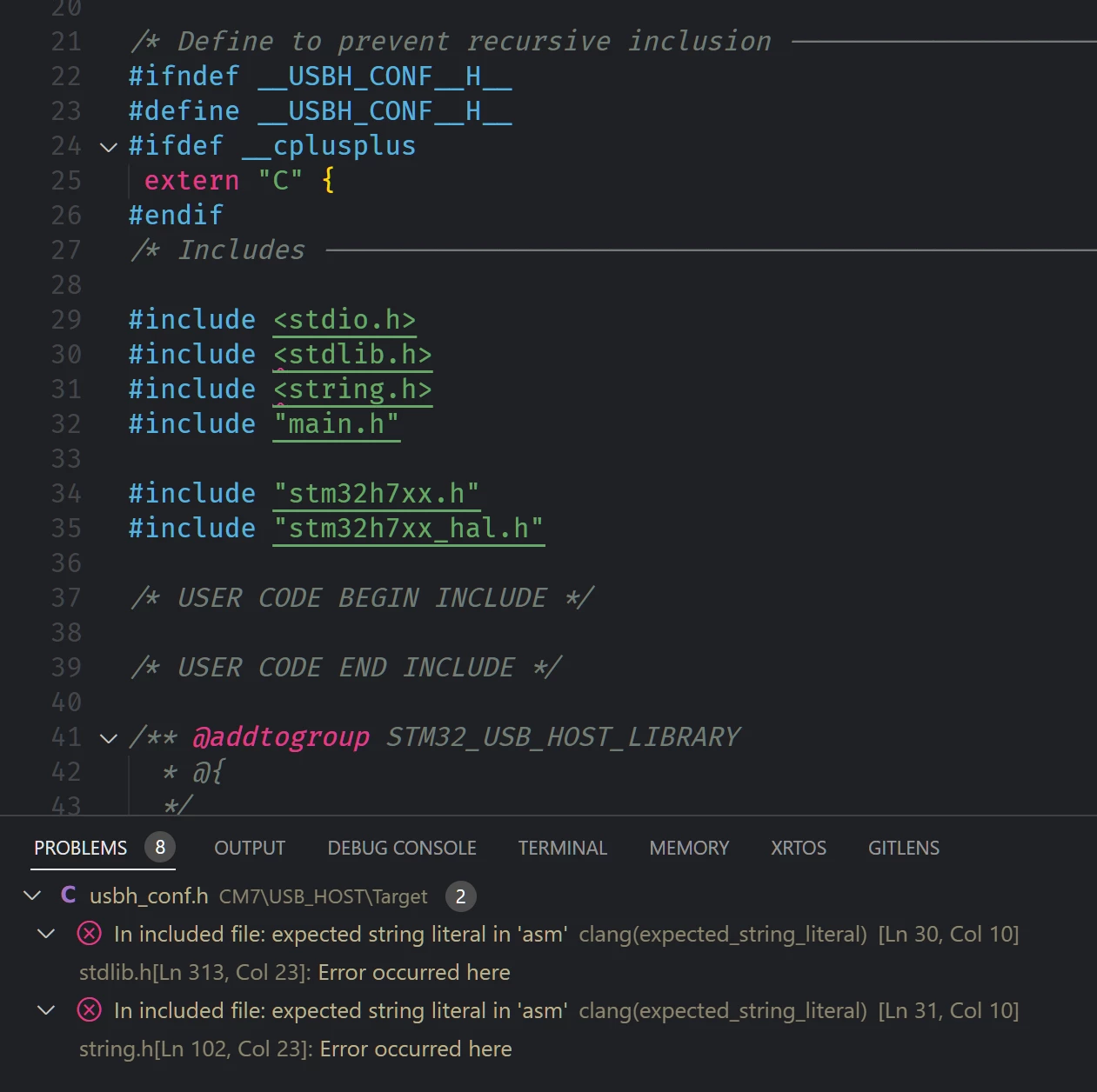

I struggle all day with configuring clangd extension for Visual Studio Code to be able to provide all code intelligence feature for STM32 project that was created with STM32CubeIDE.
I mean - it works. Kind of. I provided a ridiculous number of include directories, symbols and such (mostly copied from STM32CubeIDE), but the problem is some flags should be set differently for C and C++ files.
It seems like STM32CubeIDE does that somehow.
With clangd I figured out I can create compile_flags.txt file and point the clang extension to use that file (--compile-commands-dir=.vscode).
So here is the beginning of my compiler_flags.txt file:

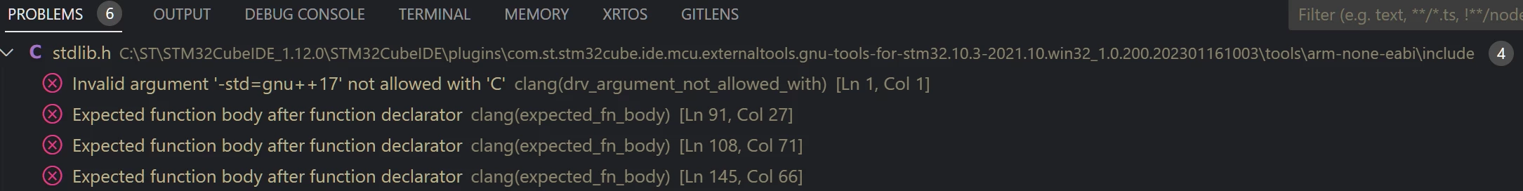

However, this produce errors like this:
_legacyfs_online_stmicro_images_0693W00000bj5KOQAY.pngYou get the point, some flags should be provided for the C compiler, some for the C++ compiler. How to achieve that goal?
BTW, I tried to used Microsoft C++ extension first, but it failed miserably with code completion. It offered me symbols from the entire codebase, instead of symbols from the class I was editing.
For that matter clangd is amazingly good. Its code completions are better than those offered by STM32CubeIDE. The only problem are those spurious errors.
For now I don't intend to compile the code with VS Code, I'm just using it as an editor.

I found a partial solution:
.vscode/settings.json:
 "clangd.arguments": [
 "--compile-commands-dir=.vscode",
 "--enable-config"
 "clangd.onConfigChanged": "restart",
.clangd:
CompileFlags:
 Add:
 - "-mcpu=cortex-m7"
 - "-DDEBUG"
 - "-DCORE_CM7"
 - "-DUSE_HAL_DRIVER"
 - "-DSTM32H745xx"
 - "-D__GNUC__"
 - "-U_WIN32"
 - "-ffunction-sections"
 - "-fdata-sections"
 - "-mfpu=fpv5-d16"
 - "-mfloat-abi=hard"
 - "-mthumb"
 - "-Wall"
 - "-Wno-unknown-pragmas"
 - "--specs=nano.specs"
If:
 PathMatch: [.*\.c, .*\.h]
CompileFlags:
 Add:
 - "-std=gnu11"
 - "-I/source/embedded/stm32-gnu-tools/arm-none-eabi/include"
 - "-I/source/embedded/stm32-gnu-tools/lib/gcc/arm-none-eabi/10.3.1/include"
 - "-I/source/embedded/stm32-gnu-tools/lib/gcc/arm-none-eabi/10.3.1/include-fixed"
If:
 PathExclude: [.*\.c, .*\.h]
CompileFlags:
 Add:
 - "-std=gnu++17"
 - "-fno-exceptions"
 - "-fno-rtti"
 - "-fno-use-cxa-atexit"
 - "-I/source/embedded/stm32-gnu-tools/arm-none-eabi/include/c++/10.3.1"
 - "-I/source/embedded/stm32-gnu-tools/arm-none-eabi/include/c++/10.3.1/arm-none-eabi/thumb/v7e-m+dp/hard"
File .vscode/compile_flags.txt contains only my project include paths.
Most of the files are processed without errors, however, I still get something like this:
