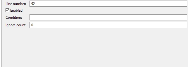

I advise you to refer to the UM2576, in section "2.4 Setting breakpoints" section.
I hope this helps !
If my answer satisfy your need, please select it as Best so that this thread will marked as solved.
Thanks
Imen
It's a boolean expression in C/C++; For example, if you want this breakpoint breaks only when the global variable global_a is equal to 100, just input global_a == 100.
