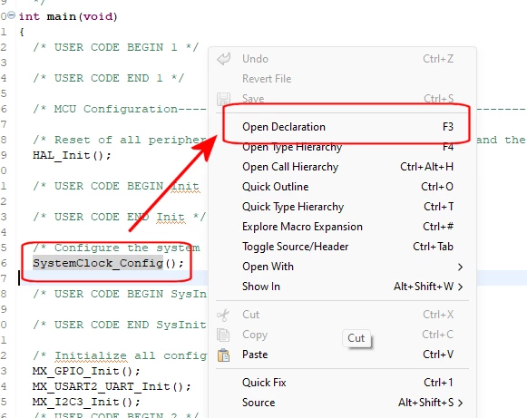

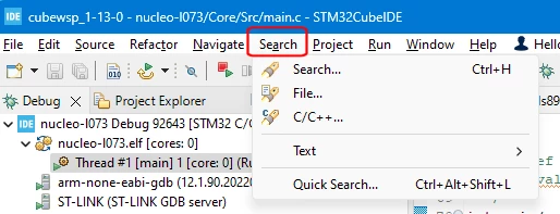

In STM32Cube, how do you word search for a particular function among dozens of HAL, middleware source files?  How to find MX_APPE_Process(); as appear in main() in main.c  TIA

Also available on the right-click pop-up menu:
See also:
EDIT
And, of course, there is the 'Search' menu:

Place cursor on the function of interest and press F3 on keyboard which should select/open the file and jump to the function within it.
See also:
EDIT
