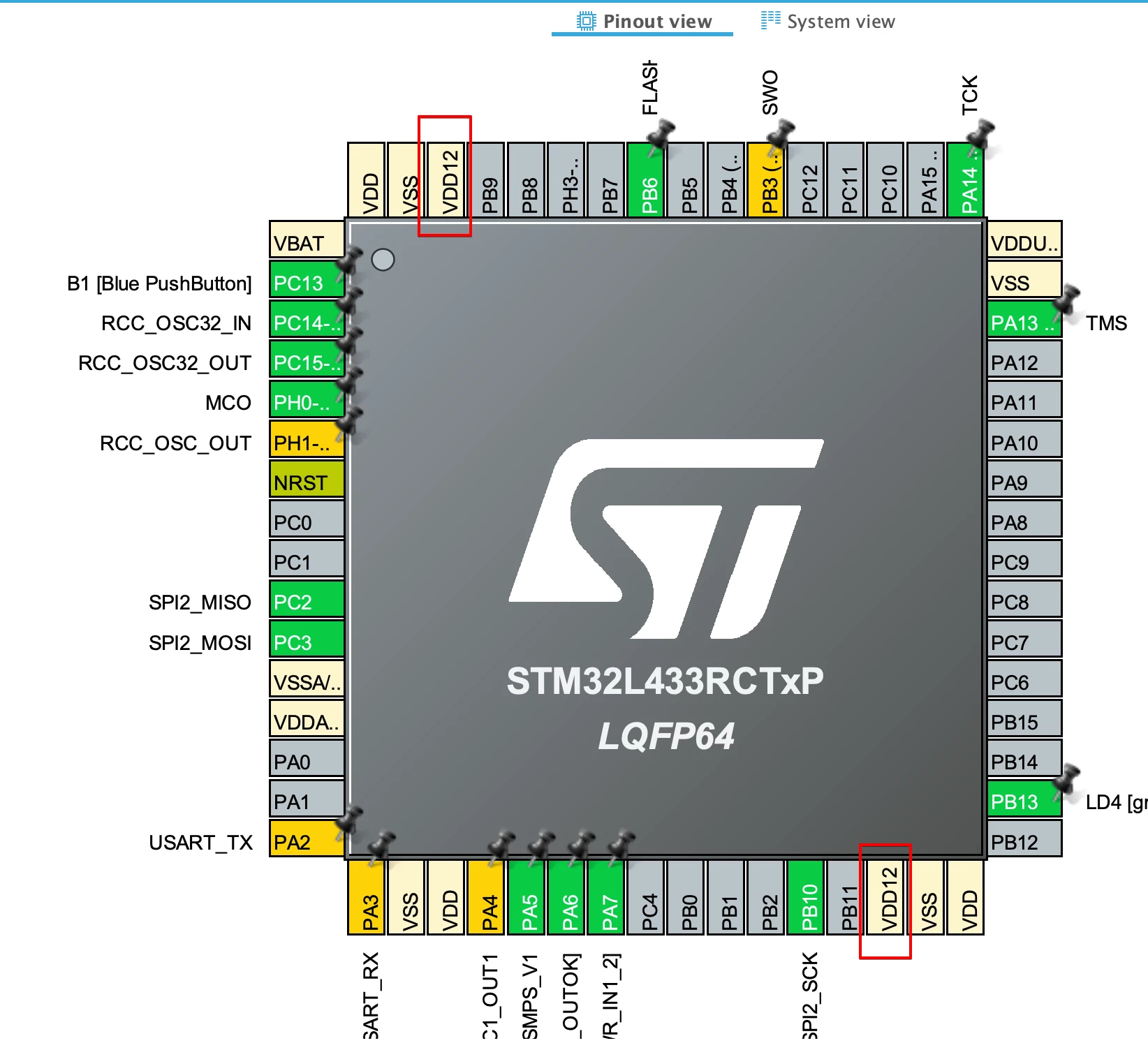

I have developed software in STM32CubeIDE using the NUCLEO-L433RC-P dev board.
This board uses the STM32L433RCT6P (which has an external SMPS for VDD12 pins) but the PCB I am designing uses the STM32L433RCT6 (without external SMPS).
When my PCB arrives, I will need to retarget the MCU in STM32CubeIDE from the STM32L433RCT6P to the STM32L433RCT6, but I cannot see how to do this.
I tried to create a new project (including the .ioc file) using STM32CubeMX and copy files accross, but got into a mess and could not get it to work.
Ideally I would like to be able to easily switch between both MCUs, so that I can continue to develop the software on the NUCLEO-L433RC-P until my PCB arrives.
How do I retarget my software to the STM32L433RCT6 ?

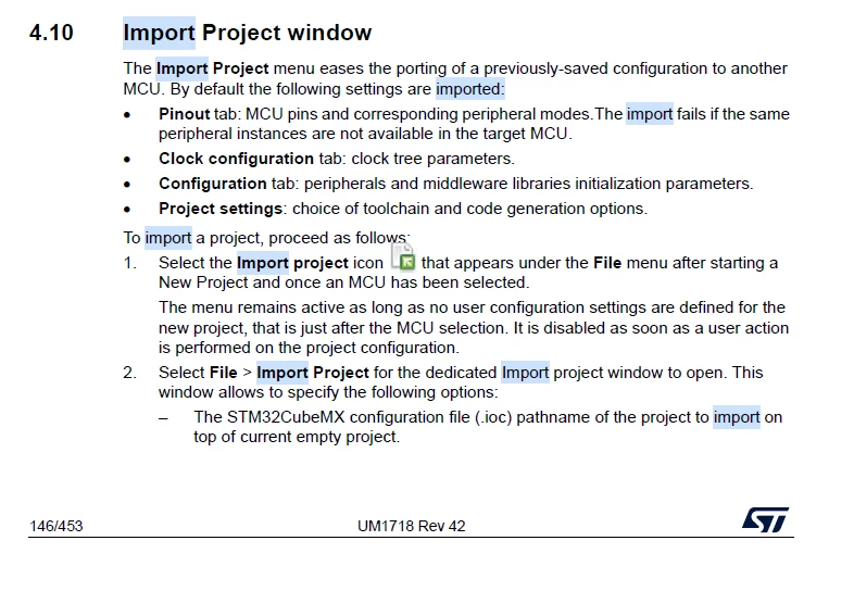

Official create new project and import ioc into it. (imported is pinout and setings)
Unofficial ioc is text file open in editor (PSPAD NOTEPAD) and change ID , use one from official ioc ...

I generated a new project in STM32CubeMX for the STM32L433RCT6, then copied the .ioc file into my existing STM32CubeIDE project (for the STM32L433RCT6P)
But when I open the .ioc in STM32CubeIDE, it still shows the VDD12 pins (which are only used on the STM32L433RCT6P)

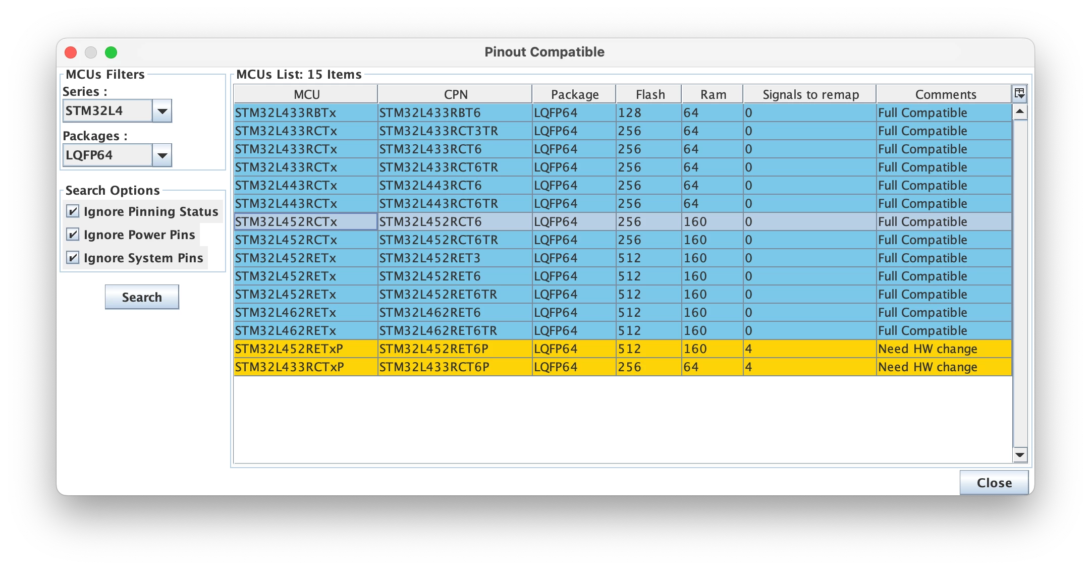

You may use "List Pinout Compatible MCUs" option,
Then look for STM32L433RCT6 in the list and click "OK import"
You will be asked to generate a new project where you need to add your user code from the STM32L433RCT6P project.

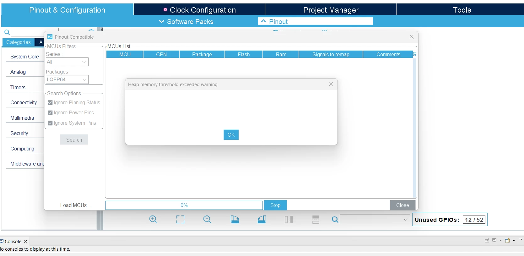

I tried that but get the error "Heap memory threshold exceeded warning"...
What does this mean ?
This is what it shows when I build code...

It seems to be an issue with Java and the numer of parts searched for.
If I narrow the search by selecting the series (STM32L4) and package (LQFP64) then it works... BUT, there is no Import (or Export) button, just a Close button....
Note I am using both PC and Mac and both behave the same

Try to use the standalone version of CubeMx and use the latest version of it.
