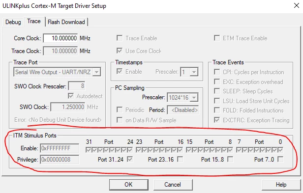

I remembered ITM settings in uVision - is something similar in Cube ? Is ITM in Cube set for semihosting internally ?
Clearly it is a black magic to me. I checked what ITM is - part of Cortex M debuging suite. So, is not this supported by STLink ? There is GBD, STLink, some code on target, Cube. Anything else in the chain ? Cannot be Cube in control of this chain so that console printf/read is woking smoothly ? Very confusing.

As I said, I have no clue what I am doing. Just trying to copy what is working (ITM) on my other project (Cortex M3, Ulink, uVision, clang) where someone else got it working. It does not need to be ITM.

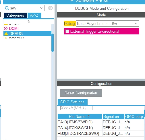

ferro
ferroAuthor
Lead
October 15, 2024
@mƎALLEm  I followed all his instructions but no success. Could you check my HW config please ?
