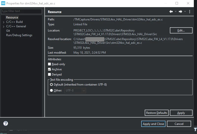

I'm trying to create process for development with CubeMX/CubeIDE projects.
I'm seeing pathing issues that show up when my project is moved. Which also means when it's cloned to another computer.
Simple steps I've done to reproduce this:
Created a new project with CubeMX. It generated the code and then imported to CubeIDE.
Project works and builds.
Now, I move the project to a different directory. (Which also happens when I clone it)
The project can no longer find files in the "Drivers" subfolder.
If I look at one of the files on the original (working) project I can see how it resolves:
 0693W00000Dmq5uQAB.pngOnce I've moved the folder it resolves different and completely changes the pathing:

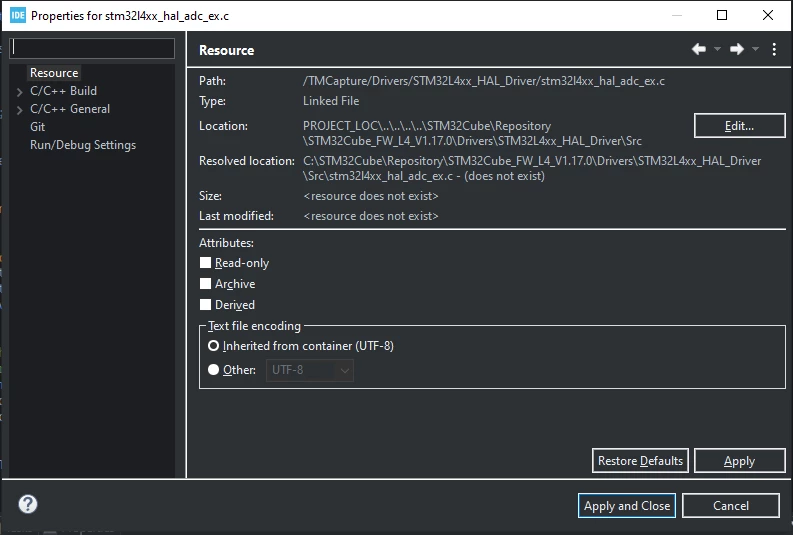

 0693W00000Dmq6JQAR.pngIn practice will want to push and then clone these projects. However, each attempt ends the same way. The pathing resolves differently than where it was generated.
How can I make this work?
KnarfB
KnarfBBest answer
September 10, 2021
CubeMX -> Project Manager -> Code Generator -> Copy only the neccessary library files should do that.

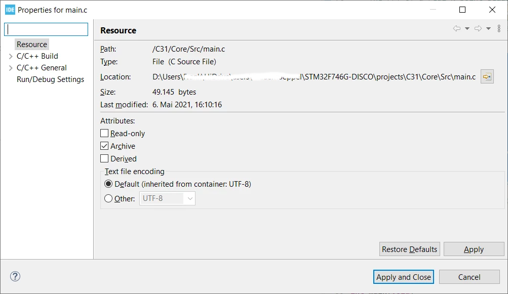

The location vs. Resolved Location looks strange to me. I use git regularily without issues. In my case, each project folder gets its own git repo. The Ressource tab looks like0693W00000DmqiIQAR.png
