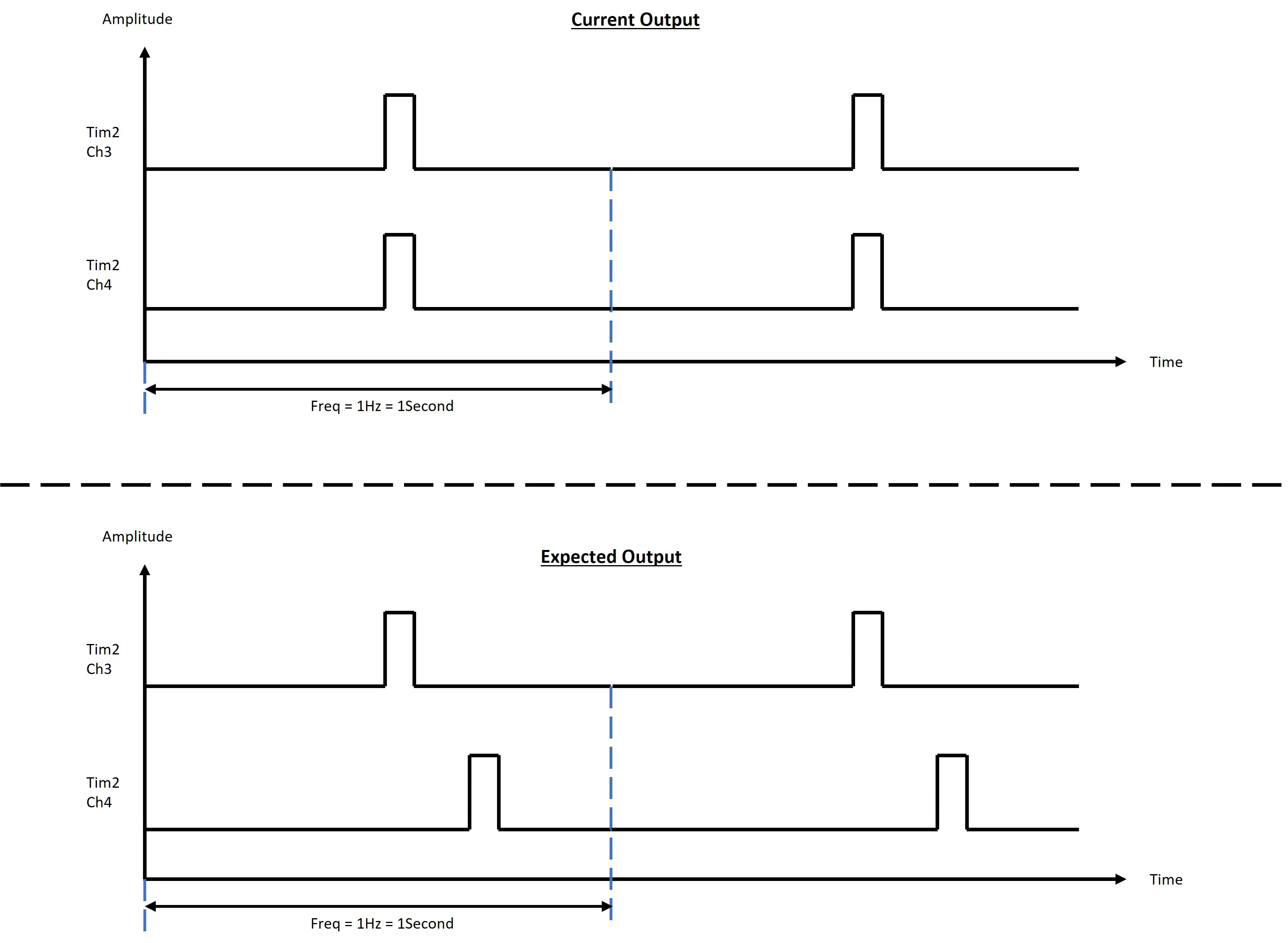

Hello Members,
I am new to STM32 MCUs. I am trying to generate PWM and try to modify on fly and it works. But my requirement is to have a delay between two pulse on time and it should not align to each other on any edge. Please see the photo to understand the expected output.
So requirement is, How to put Delay or offset Between two or multiple PWM Pulse?
MCU: STM32L476
STM32CubeIDE 1.8.0
Thanks
Bhavik

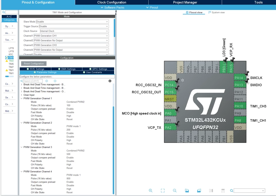

Best answer by KnarfB
The most flexible way is to use combined PWM mode available on some timers. You need 2 timer channels per PWM. This allows you to set the offset for each of the 4 edges indivually. With CubeMX like:
0693W00000JQDMDQA5.pnghth
KnarfB

waclawek.jan
February 17, 2022
Read Combined PWM mode subchapter of TIM chapter.
You can't do this with any arbitrary channel, though.

Bhavik
BhavikAuthor
February 18, 2022
@KnarfB​ Thanks for quick reply I tried the mentioned setting but It wont work.
As mentioned I am using STM32L476RG Nucleo Board for testing. Any Clue?
KnarfB
February 18, 2022
I'm using Nulceo-STM32L432KC here, should be quite similar.
Did you start the PWM channels in the code:
 HAL_TIM_PWM_Start(&htim1, TIM_CHANNEL_1 );
 HAL_TIM_PWM_Start(&htim1, TIM_CHANNEL_2 );
 HAL_TIM_PWM_Start(&htim1, TIM_CHANNEL_3 );
 HAL_TIM_PWM_Start(&htim1, TIM_CHANNEL_4 );
hth
