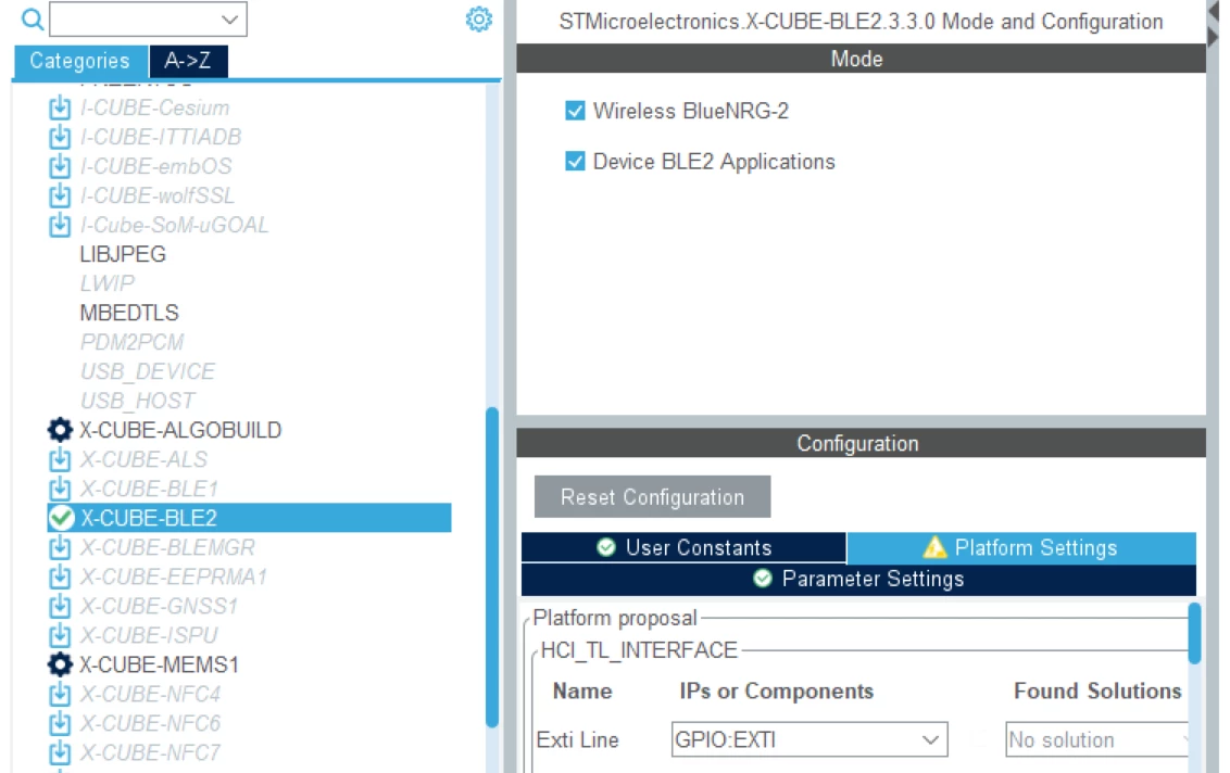

How to program BLUENRG-232?
Hello everyone. I got a STEVAL-IDB008V2 board including an BLUENRG-232. I want to program it from scratch, but I couldn't find a BLUENRG in the STM32CubeIDE Target Selector. Is there something that I'm missing? Thanks for the help in advance.
    1 reply
    Oct 19, 2023 10:05 AM UTC
    Hello @MrEmou,
    The STEVAL-IDB008V2 board is not supported, that's why, it's not available in the selected board list.

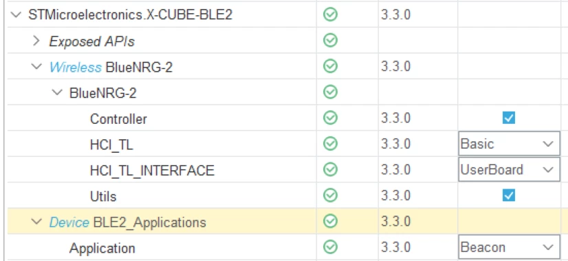

    If you want to configure it, I suggest that you install the X-CUBE-BLE2 pack.
     In order to configure the BlueNRG, please follow steps mentioned below:
    1- Create new project using STM32 MCU
    2- Select component under Software packs
    3- Enable the X-Cube-BLE2 with your configuration, then press OK
    4- Configure your pack under Software packs available in the category part
    The image attached will help you to understand the steps described above.
    Thanks.
