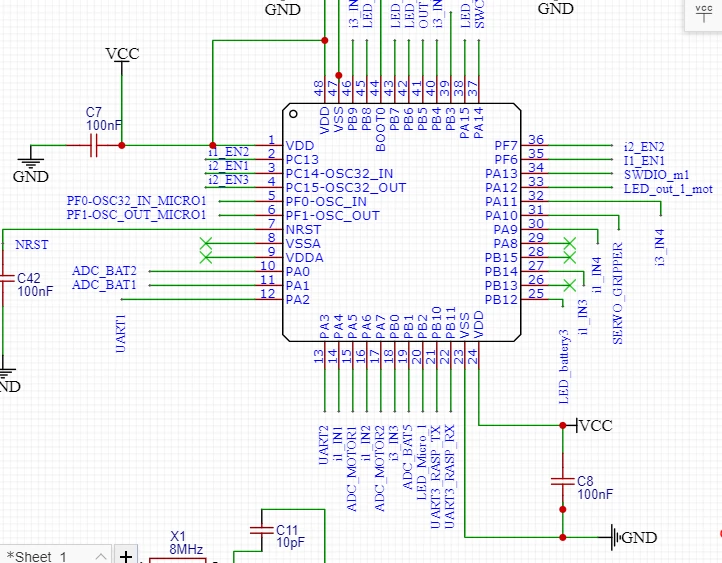

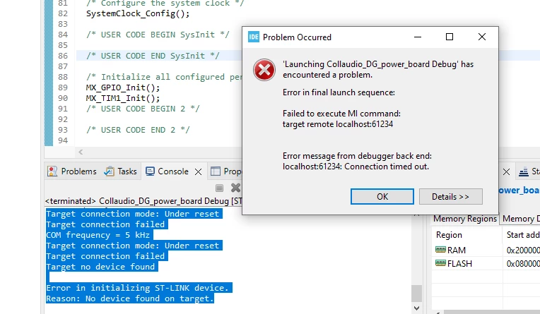

I developed a boiard with micro STM32F030C8T6TR. But when I try to create a software in STMcubeMx Build and Debug. I can always  build succesfully my project, but When I try to Flash and Debug STcubemxIDE  open a popup with wrote, as following reported:
Target connection failed
Target no device found
Error in initializing ST-LINK device.
Reason: No device found on target.
I'm usinf STM32 LINK v2 Debugger, with SWD I respected pinout connection. Following, microprocessor section, taken on the schematics:
And the Debug connector schematics
SomeBody Can help me to understand Why I cannot Flash and Debug, receving error messsage.

    MM..1
    July 2, 2023
    Your schematics is buggy need connet VSSA and VDDA
    vdavi81Author
    July 2, 2023
    But I don't need to use Analog, then VSSA and VDDA are not mandatory.
    MM..1
    July 2, 2023
    MCU isnt analog as you mean, for example ADC part power on reset or clock oscilator is powered from "analog" as you connect now your MCU is dead
    vdavi81Author
    July 2, 2023
    Ok I tried to connect both of VDDA and VSSA, Can I connet them to VDD e GND? SWD Debug Peripheral need VSSA and VDDA?
    Another question NRST need pull-up Resistor?
    MM..1
    July 2, 2023
    Open Nucleo 030 schematics and learn.
