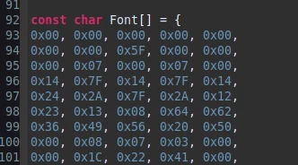

so, what did you write?

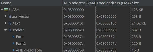

ie from prog on stm32f103 : graphics font for tft
and in mem:

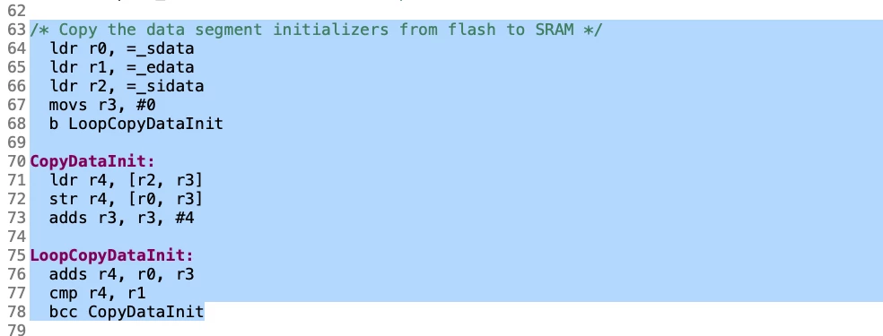

Unfortunately, this is not fully correct. Space is also reserved in RAM, and the startup code (startup_stm32f407xx.s) initially copies all data from Flash int RAM. See the relevant part from my startup file (auto-generated by Cube IDE) in the attachment.

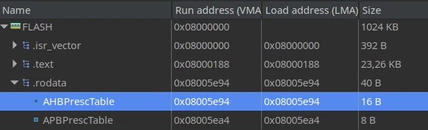

ok, so for F411 board:
and (with unmodified settings)
const var -> in flash. only.

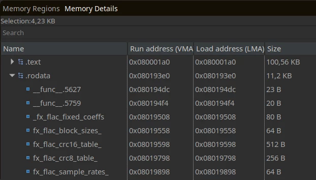

(here a flac+ mp3 decoder running, tables never would fit in his small ram)
++ found F407 prog now:
gives
Bob S
