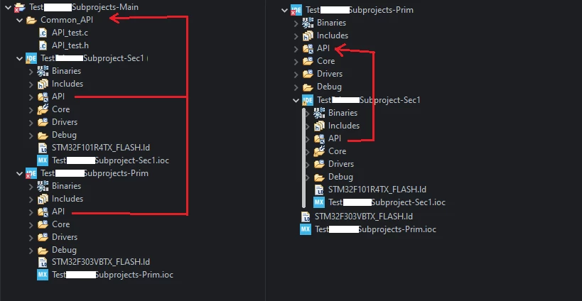

Hi, I have a challenge about IDE configuration and build steps to make a clean new project.
The context is the following : I have a device including 2 micro-controller, 1x STM32F303 and 1x STM32F101. The F303 communicates with the serial bootloader input of the F101 through an isolation barrier as safety requirement. The goal is to bootload the F303 using STM32Cubeprogrammer and let it update the F101 at next power on.
What I need is to create a project that allows to debug both uC (ideally at the same time). So far its easy. But I also need to include the image of the F101 uC inside the image of the F303 uC to allow the update mechanism mentionned above. This should ideally by transparent for the devs once configured to avoid human errors : building the F303 project should trigger a build of the F101 as pre-build step before building the F303 image that include it.
I feel like I need to have either a master project including both or a nested project. Attached the structure I obtained trying both options. Arrows represent folder links to the shared part of the code. Any advice on one or another is welcome.
My main question so far is :
1) How can I configure the main project to build the nested one(s) ? I know about prebuild steps but would like to make sure of what command line I should use to guarantee the same build as clicking on "Build" manually, taking nested project(s) properties and configuration into account.
Follow up question would be :
2) How should I then embed the subproject binary image in the main one ? Should I have a look in the linker syntax or is there an easier way ?
Thanks a lot for your insights. ;)

1)
Go into project properties -> Project References in the F3 project and select the F1 project. That will cause the F1 project to be built before.
2)
One way would be to convert both outputs to BIN files, then combine them. You would need to leave room for the second BIN file and pad accordingly.
I don't see how debugging both projects at once would be possible.

Hi TDK,
Thanks, indeed this is a straightforward solution to get the dependency to compile. However I noted while experimenting that it does not build the F1 project if it is not opened in the workspace but still run the F3 build without warning. The danger is to modify the common code, build the F3 project and not noticing the F1 is not yet updated. Do you know of any way to further strenghten the process against this ?
