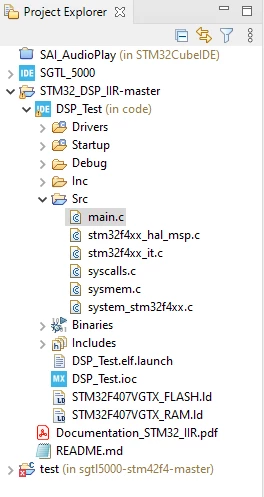

How to open an existing project

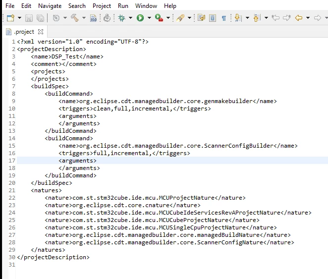

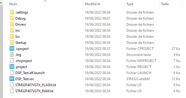

I would like to open an existing project :
0693W00000NsEjyQAF.pngBut when I select .'project' I have this picture and I can't see the code :
0693W00000NsEk3QAF.pngDo you know how to do ?
Thank you for your helps
Regards
Pavel A.
Pavel A.Best answer
Jun 19, 2022 1:29 AM UTC
  1. Start CubeIDE. If it prompts for workspace, point it to some workspace or create new
  2. File -> Import-> Existing projects into workspace
or File-> Open projects from file system

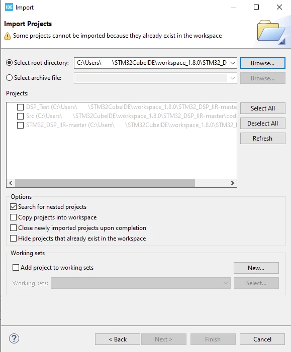

After Start CubeIDE\point it to some workspace\ File ->Import -> Existing projects into workspace I have this picture : 0693W00000NsFEmQAN.png It's  already exist in the workspace but I don't see anywhere. I have always the same windows as my previous message.
DYann.1
DYann.1Author
Senior II
Jun 19, 2022 9:52 AM UTC

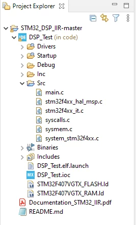

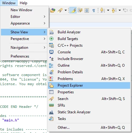

After activating the tab
0693W00000NsFG4QAN.pngNow I can see the file

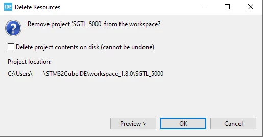

0693W00000NsFG9QAN.pngBut How I can close the 'SGTL_5000' and 'SAI_AudioPlay' because this is not the project that I would like to open. I only work with the project 'STM32_DSP_IIR-master'. Unless it's not important and I can leave it that way ?
DYann.1
DYann.1Author
Senior II
Jun 19, 2022 9:58 AM UTC
I think it's with this option : 0693W00000NsFGEQA3.pngNow it's look like correct after me :
Pavel A.
Jun 19, 2022 1:14 PM UTC
Right click on your project in the left pane -> Close unrelated projects

Jun 20, 2022 2:10 PM UTC
Hi Pavel A,
Now It's good.
Thank you
