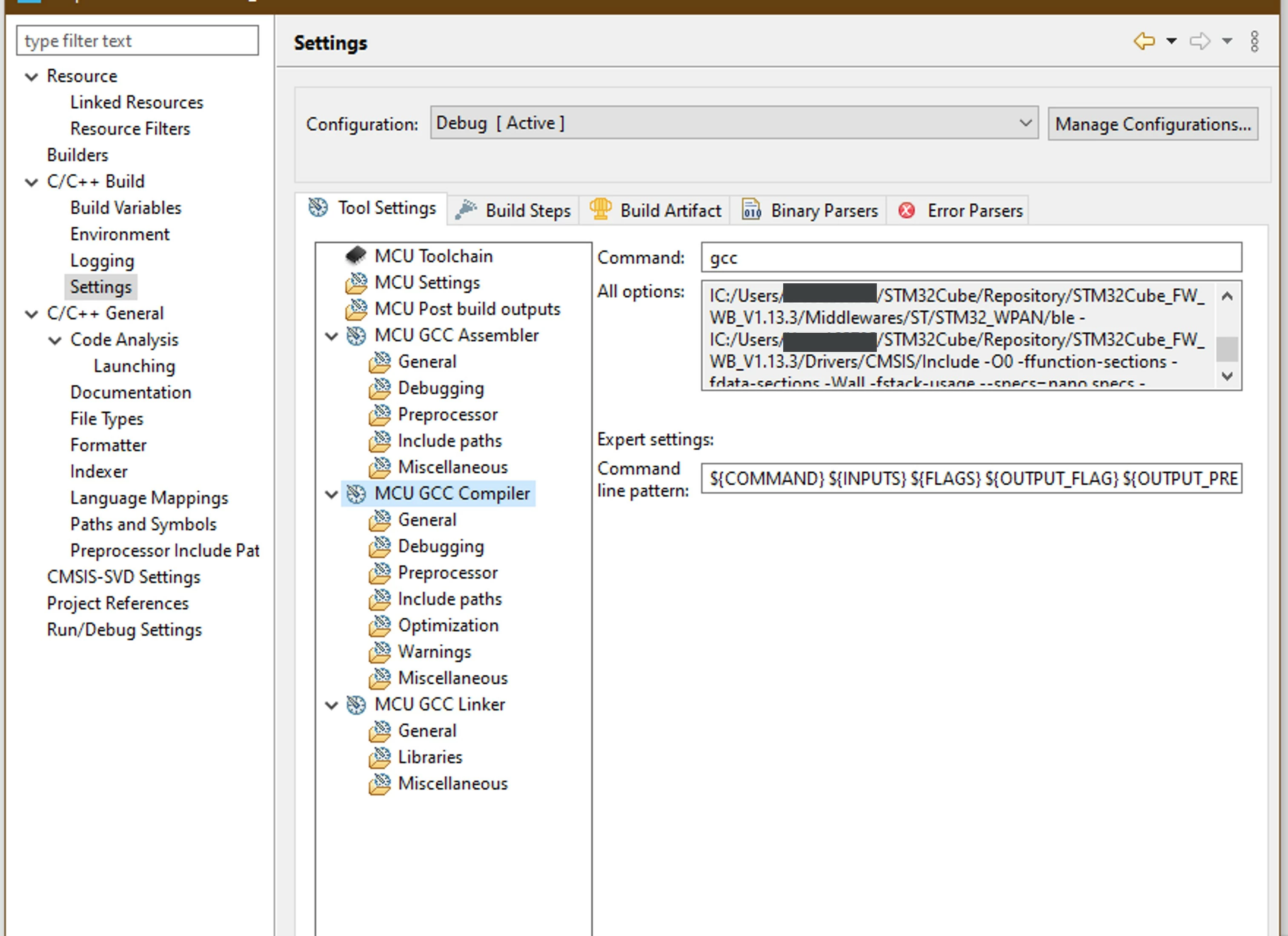

Hi, JMala.3, it didnt work. Here is what I got:
15:29:41 **** Clean-only build of configuration Debug for project projectxxxx_v3 ****
make -j8 clean
rm -rf default.size.stdout sensorwafer_v3.elf projectxxxx_v3.list projectxxxx_v3.map
15:29:42 Build Finished. 0 errors, 0 warnings. (took 232ms)
15:29:42 **** Build of configuration Debug for project projectxxxx_v3 ****
make -j8 all
make: *** No rule to make target 'C:/Users/Person12345/STM32Cube/Repository/STM32Cube_FW_WB_V1.13.3/Utilities/lpm/tiny_lpm/stm32_lpm.c', needed by 'Utilities/stm32_lpm.o'. Stop.
"make -j8 all" terminated with exit code 2. Build might be incomplete.
15:29:42 Build Failed. 1 errors, 0 warnings. (took 409ms)
The projectxxxx_v3 was zipped and sent by Person12345. I am the Person67890 and have different version of STM32Cube_FW_WB_V1.14.1 : 'C:/Users/Person67890/STM32Cube/Repository/STM32Cube_FW_WB_V1.14.1/Utilities/lpm/tiny_lpm/stm32_lpm.c'
I tried to manually change the path settings in project property. But it seems there are still other places I don't know.
I can install the version in the copied project. But I cant definitely have the same absolute paths of the original.
-WQ

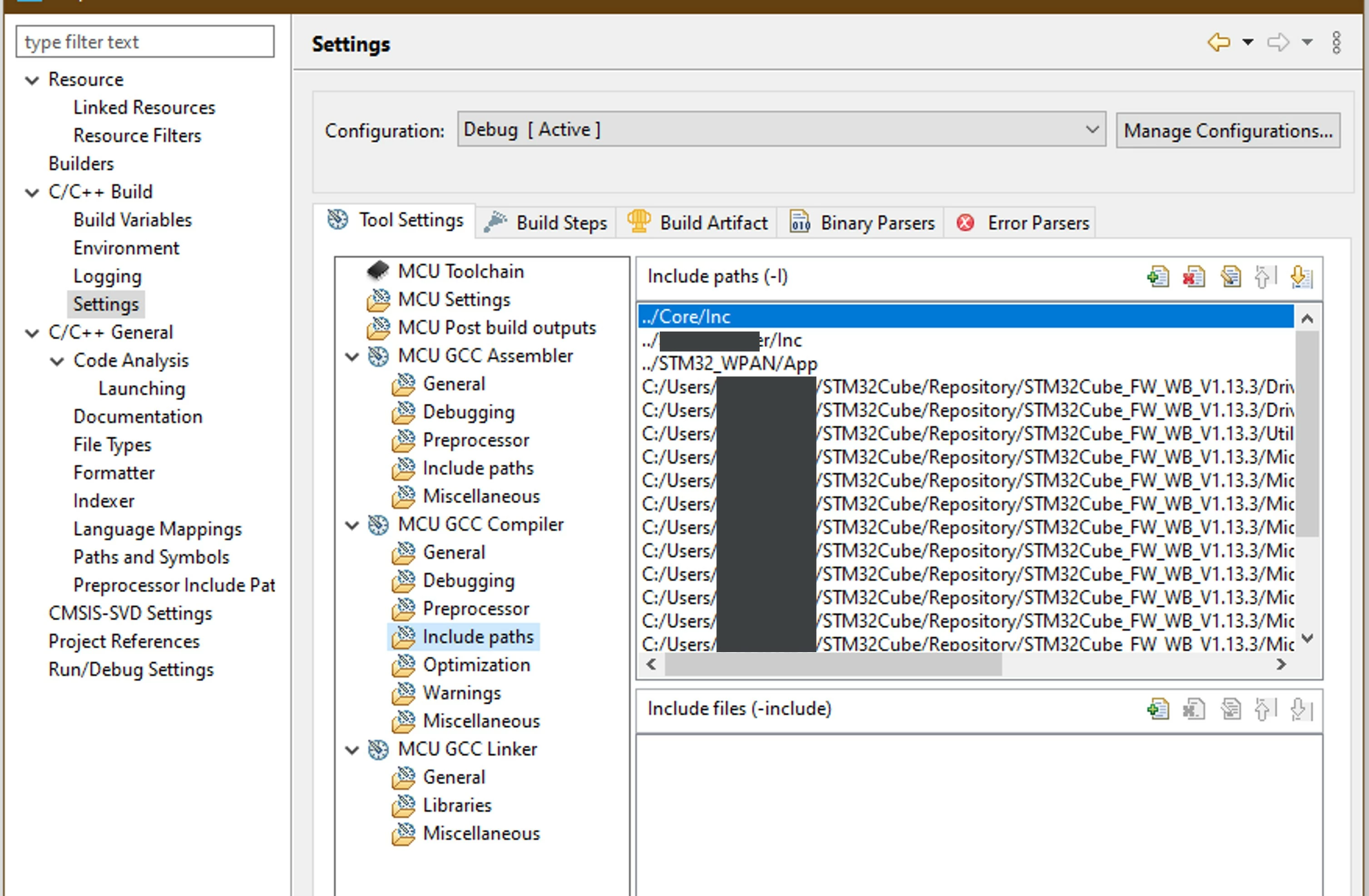

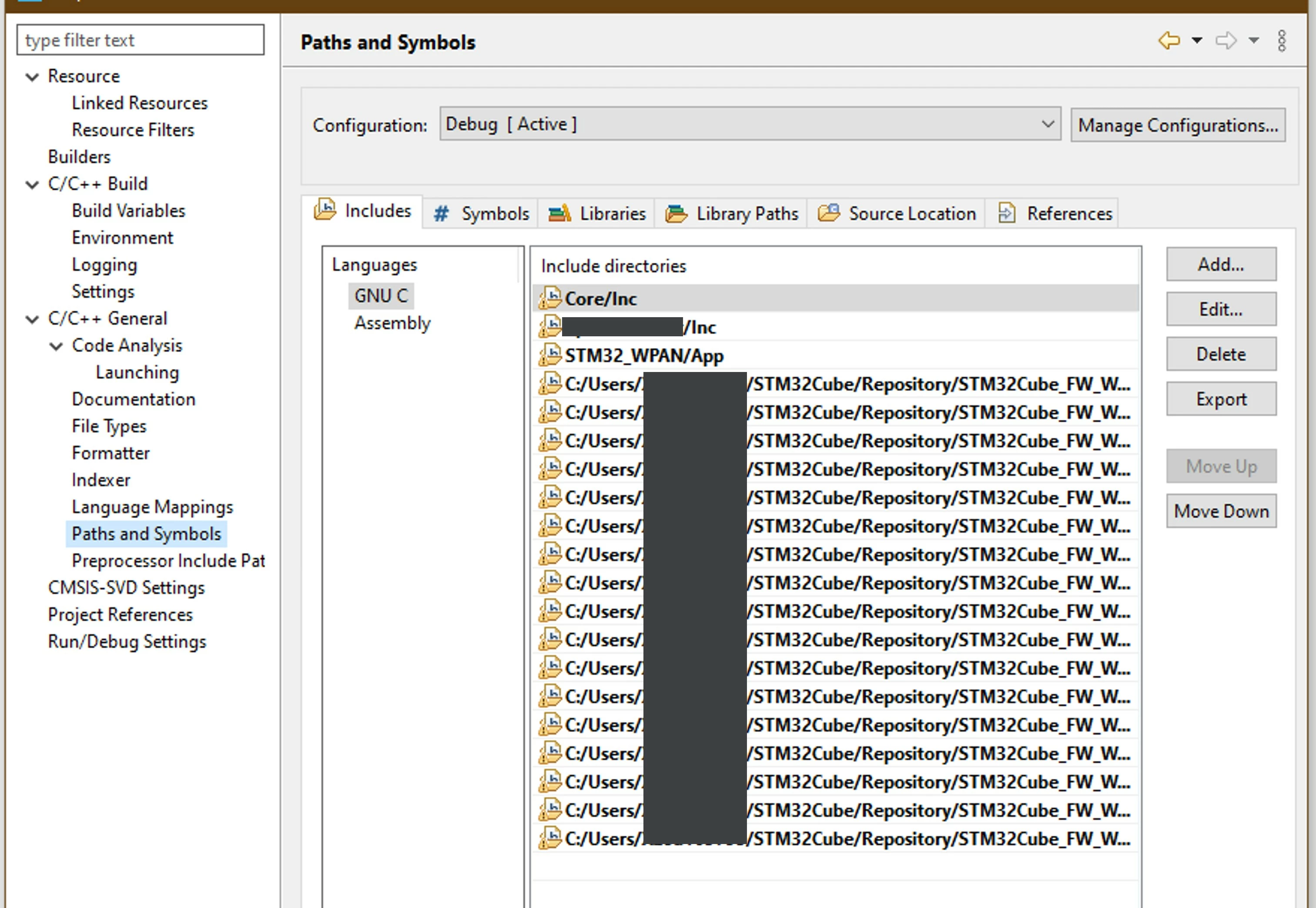

Regardless you have to clean the project from absolute paths :
  • MCU GCC Compiler - includes path
  • MCU GCC linker - Linker script field
  • MCU GCC linker - using a static libraries? make sure that it use relative paths
  • Debug configurations - Try to recreate the debug configuration since the .launch file may contain some absolute paths

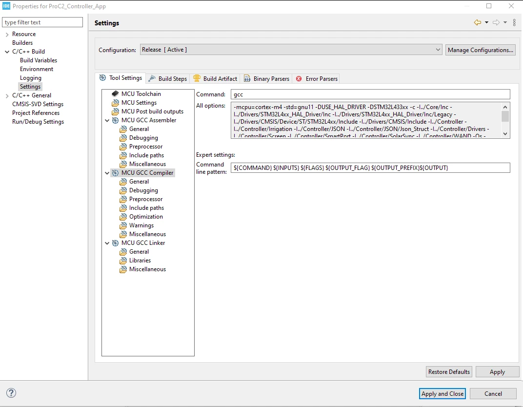

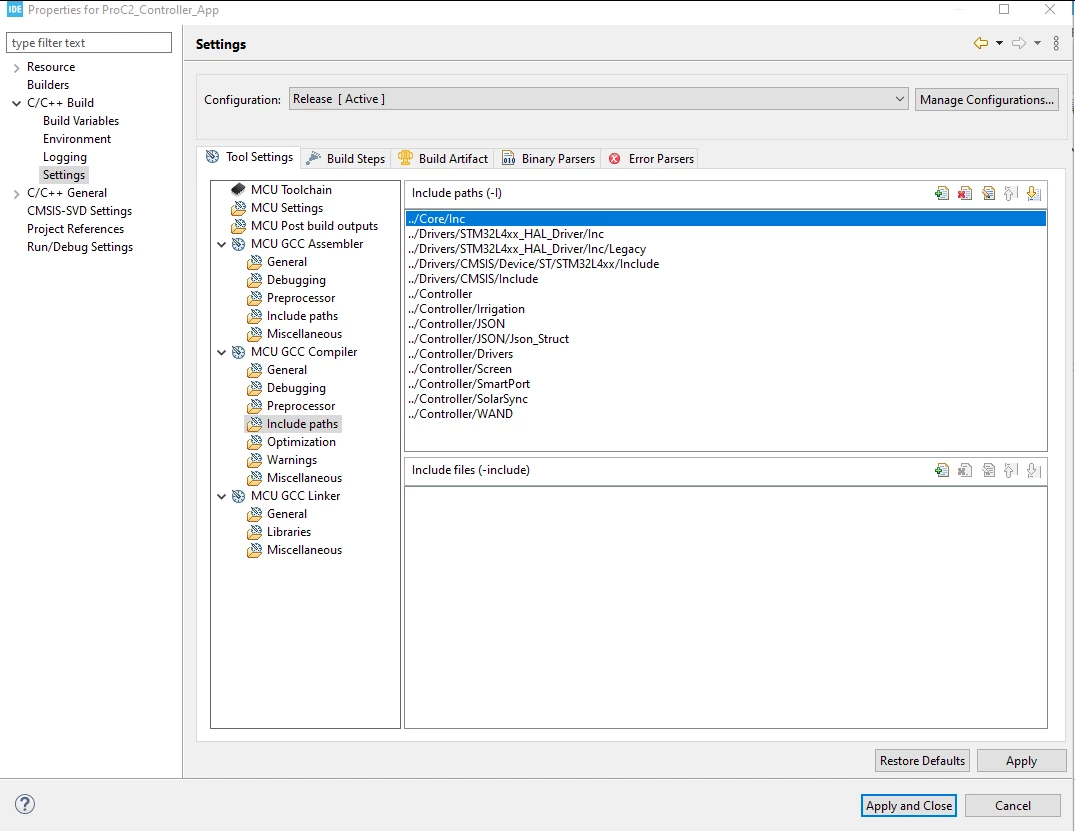

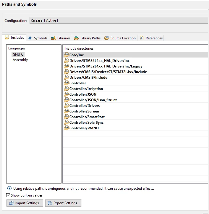

JMala.3
August 26, 2022
That weilrd, How was the project start ed originally. We do use Source control and we have 3 or 4 people using the same source files .. Here are the compiler settings in our code.
