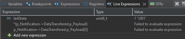

Hello @ledi7
Live Expressions can only evaluate variables that are currently in scope.  p_Notification is a local variable of a function that has exited
void OTA_Notification(OTA_NotificationEvt_t *p_Notification);
 its memory may no longer be valid, leading to evaluation failures. Ensure you are trying to access the variable while still within the function where it is defined.
or  consider using global variables for debugging purposes, as they tend to be more stable in Live Expressions

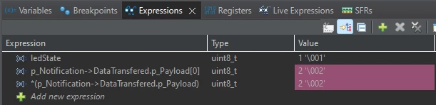

ledi7Author
November 13, 2024
Hello @Ghofrane GSOURI ,
thank's for your reply. That works in "Expression Window"
but not in "Live Expression Window" as you can see here:
