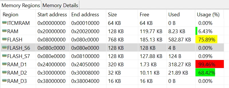

I am using stm32h723/33vgh6 development board. In that i am getting OUT of RAM memory i need to move some of runtime functions in object file to another RAM section from RAM_D1 or merge the RAM partiton into RAM_D1 to overcome from that issue.
is it possible to do merging of ram partitions to overcome the issue. i am attaching memory analyzer photo below
please give some solutions.

    Maybe you have 1000+ variables, but you likely only have a few very large one. Manage the placement of those manually.
    Other options include getting a processor with more contiguous RAM, or using external SDRAM.

    The memory regions are often predefined in the hardware and set up in the linker script and configuration files provided by the board's vendor or manufacturer.

    is there is no possibility of merging the RAM sections manually? inbetween there is reserved memory is present. if yes please give some solutions otherwise any alternative options todo that issue solved?
    December 18, 2023
    There's no way to merge them seamlessly and have the linker handle it automatically. You can assign individual variables to other regions manually.

    Actually here there is 1000+ variables are present and funtions also. is there any possibility to move the entire library object file into RAM section.
    please provide some suggetions to solve this RAM issues.
