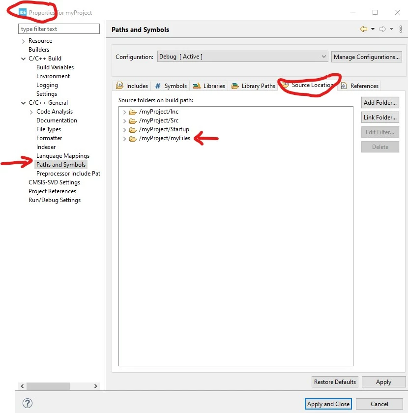

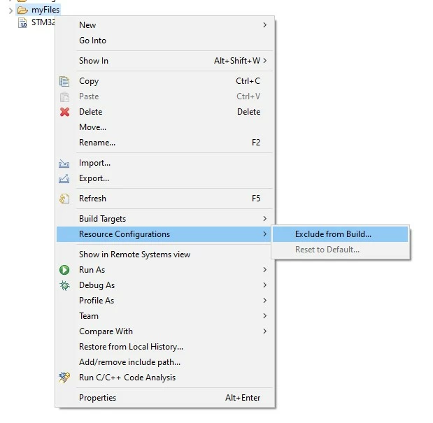

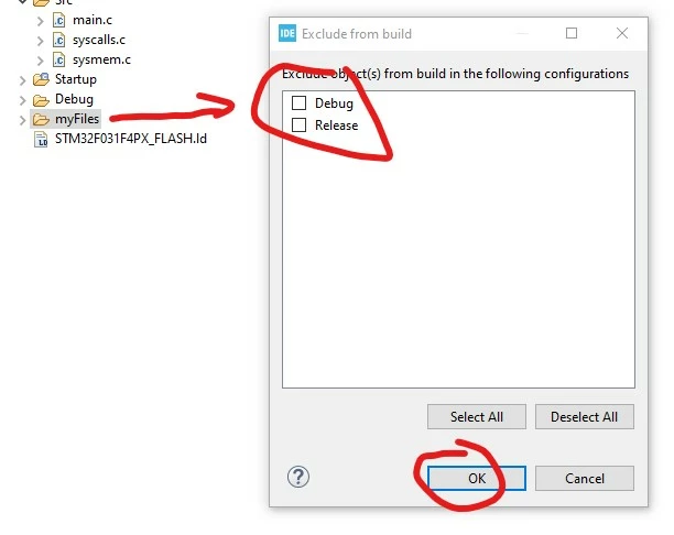

No a STM32CubeIDE issue but common Eclipse CDT usage.
At a point you have to explicitly add files / folders you want to include to compile process. Such are so called source(s) entry(ies)
1) Right click on resource(s) to add
0693W00000AMYFiQAP.jpg2) Include whatever build configuration
3) Notice some small green "C" as resource(s) icon overlay <=> here you are !
Please note can be added and/or checked thru project's properties

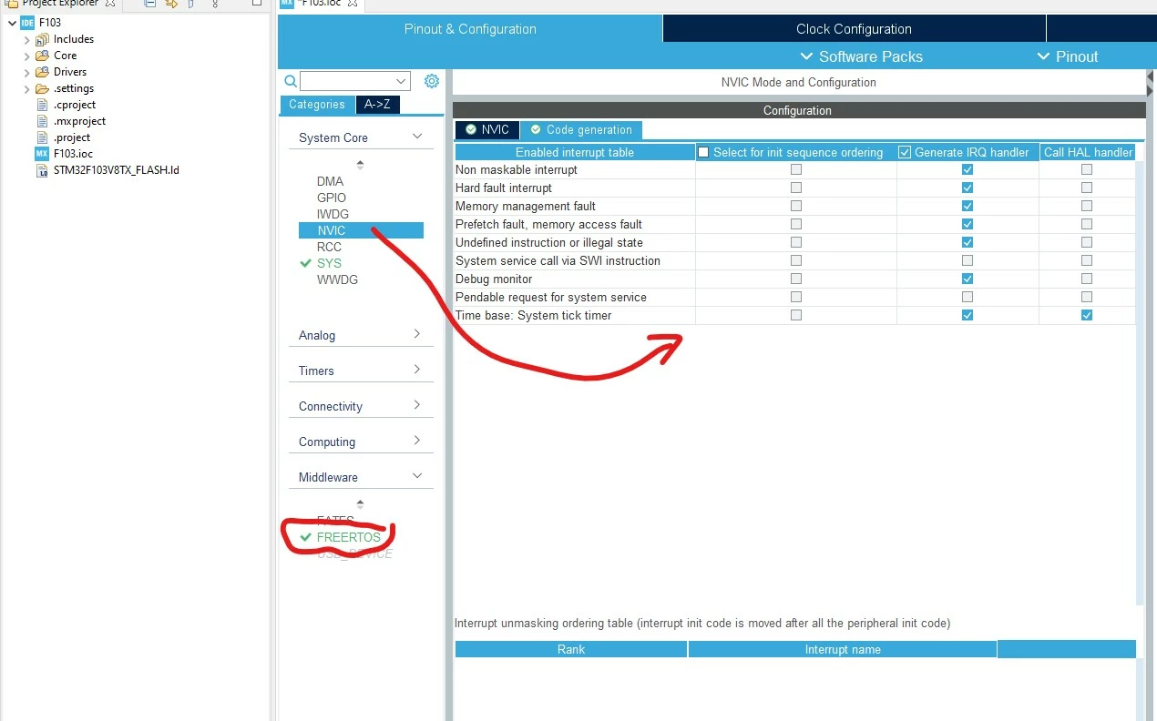

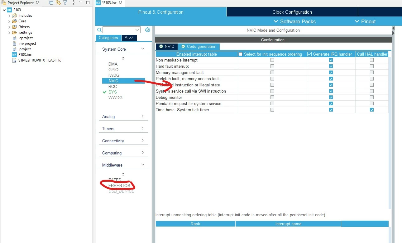

I guess still fully doable but have to consider required setup.
If FreeRTOS MW added to configuration:
If FreeRTOS MW is no part of configuration:
So if disabling FreeRTOS from adding it by yourself you have to untick some of generated IQ handlers ...
Such is about interrupts only ... maybe some other related setups but according to me Device Tool Configuraion should allow you to reach your goal ... just have to find proper settings ...
