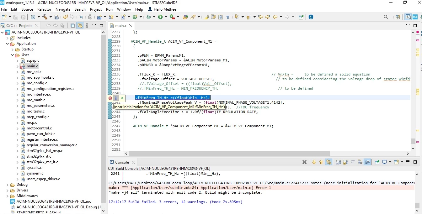

    December 3, 2023
    Dear Tesla DeLorean,
    I need to read data from eeprom for change information in parameters of MotorControl Workbench 6.2.0 project.
    But function parameters need to be const float or #define only.
    Please help advise.

    Piranha
    Principal III
    December 3, 2023
    That is not a function, but a structure initialization. You need to learn the C programming language first before trying to deal with complex software development.
