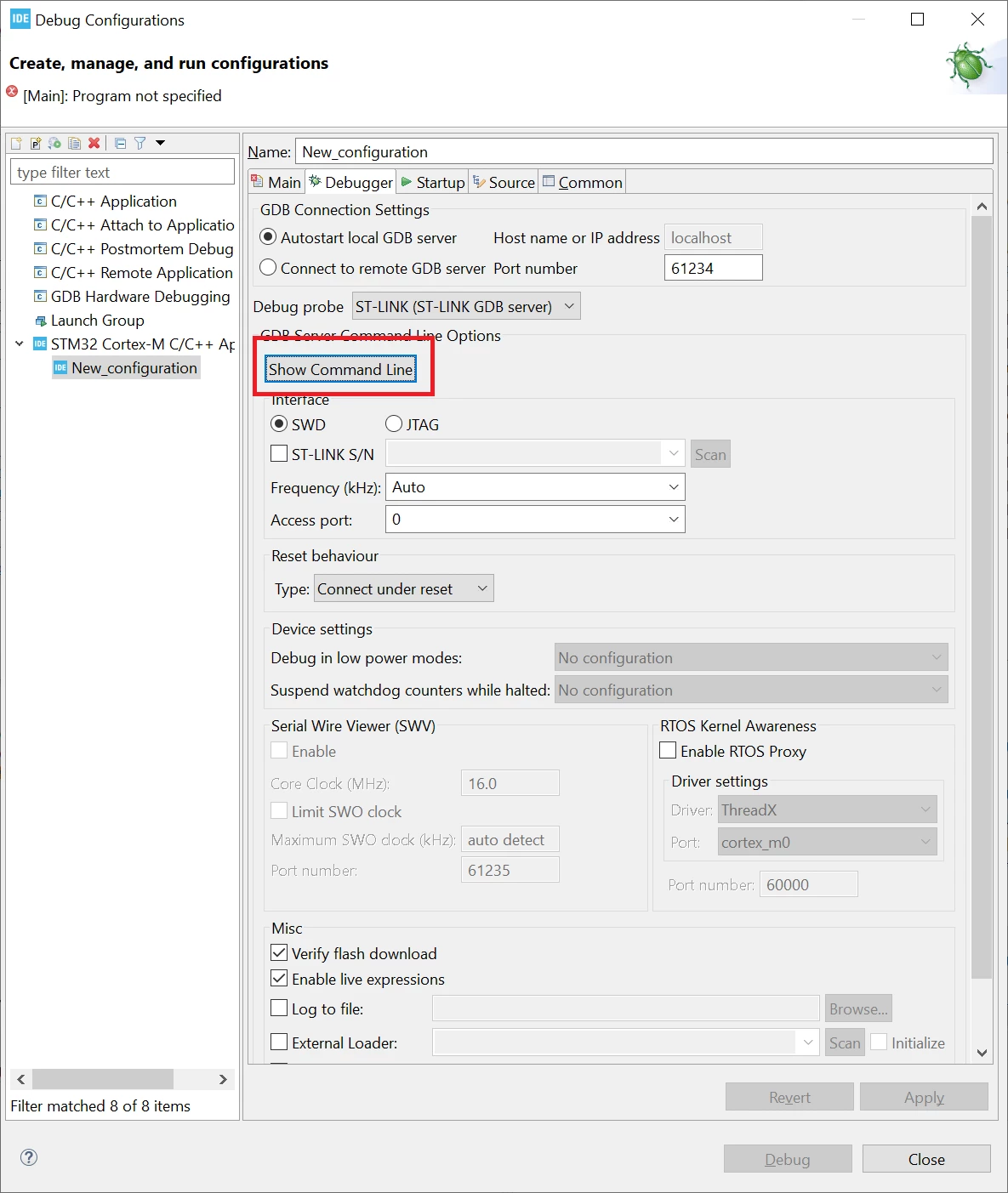

Markus GIRDLAND
October 21, 2021
Hello again Venkatesh,
Are you using J-Link or ST-Link GDB server? The error indicates that it can not find an ST-Link connected and the Port Number that is being listened to is 2331, which is the default for J-Link.
You can go into the debug configuration through the GUI of your application and see the exact command line that is being used by clicking on the button highlighted below:
