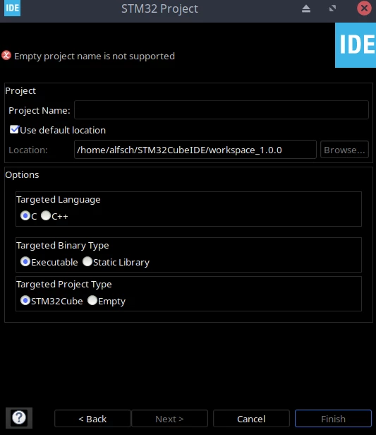

Create the STM32 project with C++ target language option. This enables both, C and C++.

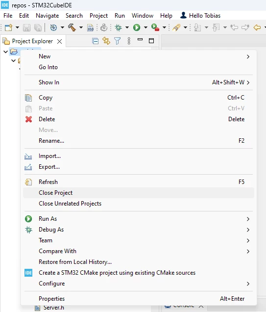

It is possible to convert an existing project to use c and c++. In CubeIDE, select the desired project in the "Project Explorer" window. Right-click on the project and select "Convert to C++" (near the bottom of the menu).
You will need to update the project to find the new include files and new source files. To add include directories go to project properties, the "C/C++ Build-> Settings". Look for "Include Paths" and add your new include directory. Do this al ALL BUILD TYPES (i.e. debug and release) as well as both "MCU GCC Compiler" and "MCU C++ Compiler" settings. To add the source directory, in the project properties select "C/C++ General->Paths and Symbols". Click on the "Source Location" tab and add the folder with your new files.

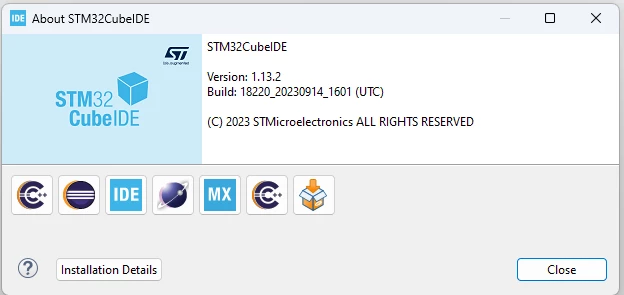

There is no such submenu in the current IDE (1.13.2)

1. for new -> project -> stm32project -> select cpu -> then:
- give name + sel. c++
2. on existing project right mouse click -> on existing project
- then choose : convert to c++
ok?
