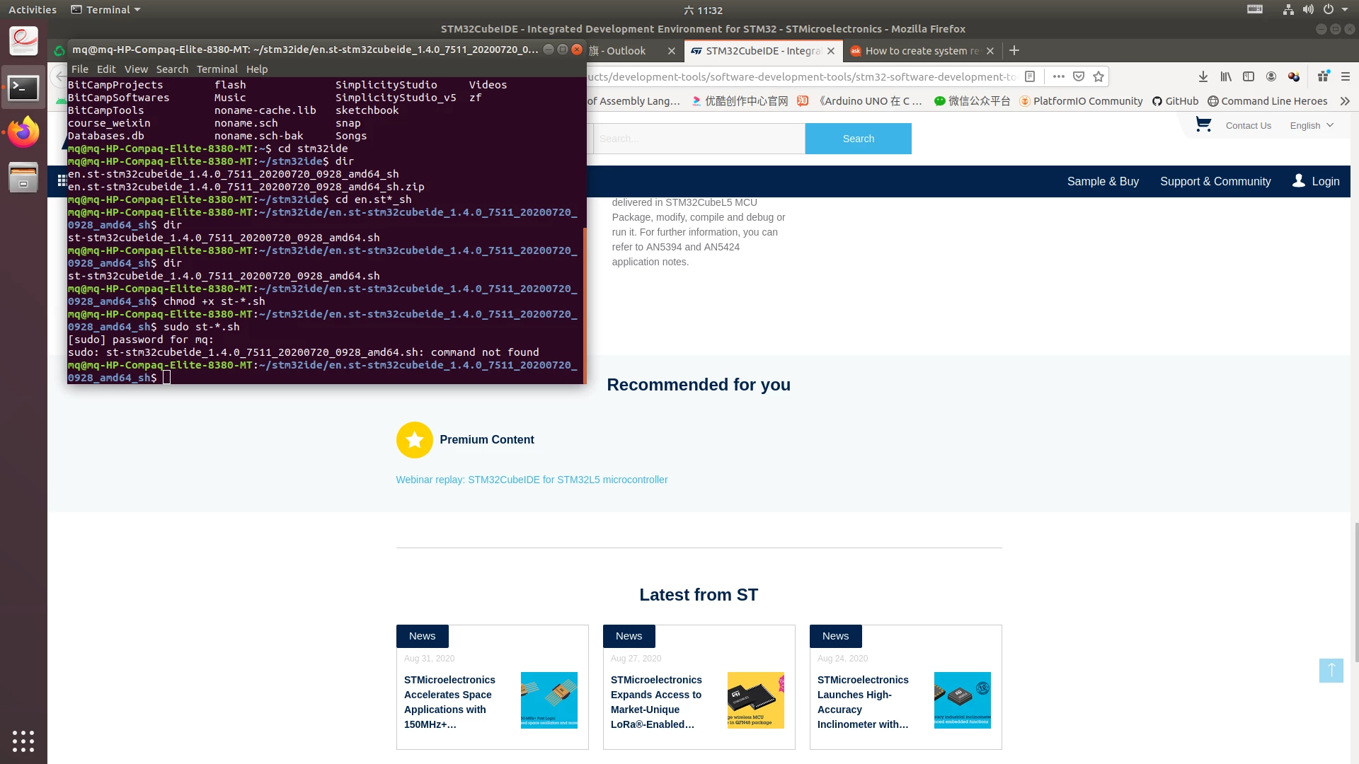

I downloaded and installed "Generic Linux", and got these:

I do not see the .sh script, are you sure that you're not trying to execute the extracted folder from the zip archive.
Try cd en.st-stm32cubeide_1.4.0_7511_20200720_0928_amd64_sh first and do the chmod command on the .sh file.

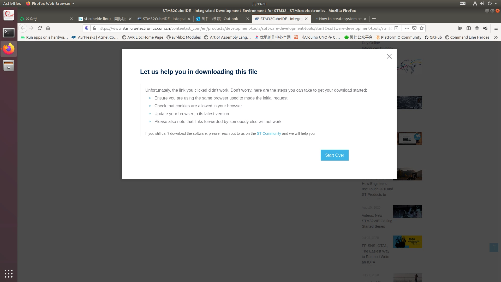

I could only download "STM32CubeIDE Generic Linux Installer", since when I downloaded "STM32CubeIDE Debian Linux Installer", it would also sent me a link, but when I clicked the link, it prompted:

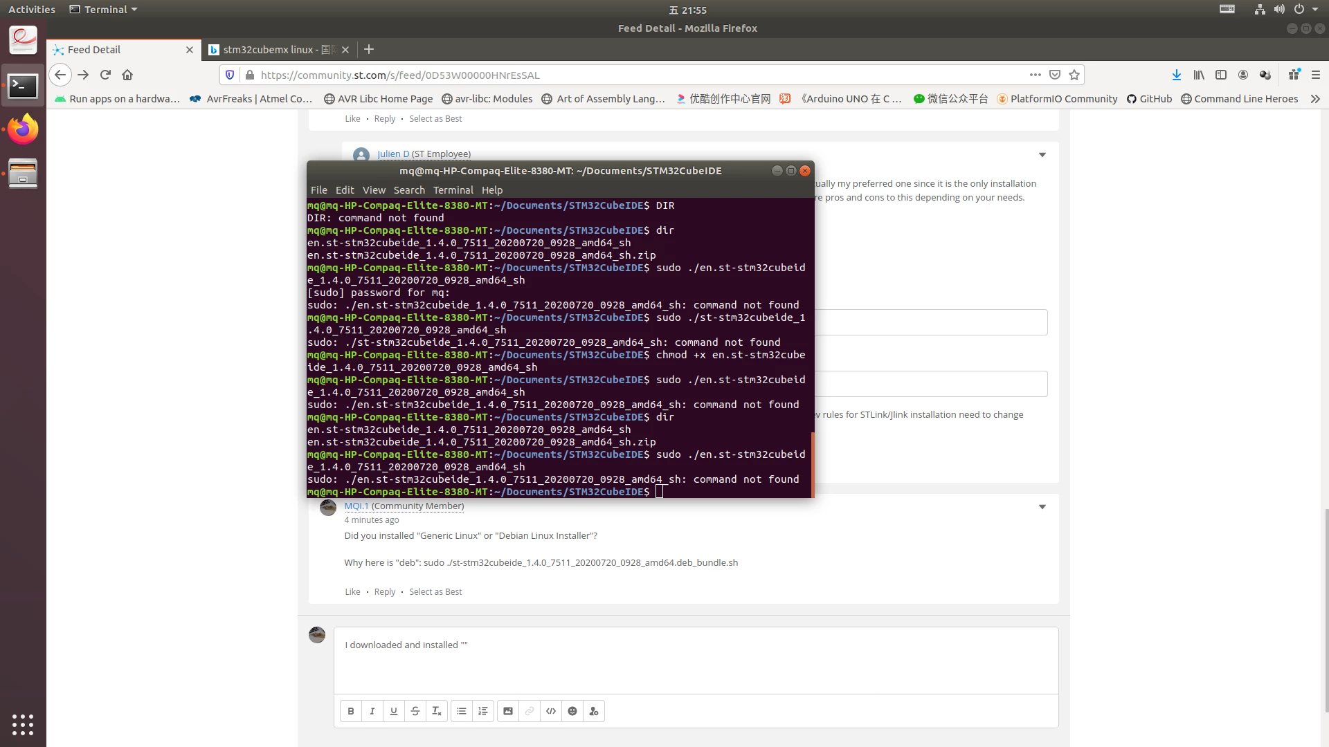

I deleted the directories, and downloaded again, unzip--> chmod +x --> sudo ...
it was the same:

There was some advance, I found that it was not "sudo ./st-stm32cubeide*", but "sudo sh ./st-stm32cubeide*"
at the end of the prompt in CLI, there were "I accept" and "I don't accept", but one should careful on clicking "Enter", otherwise you maybe slide over the option, and have to "arrow up --> Enter " and select again.
But it still prompt something missed, so I am still looking for solution.

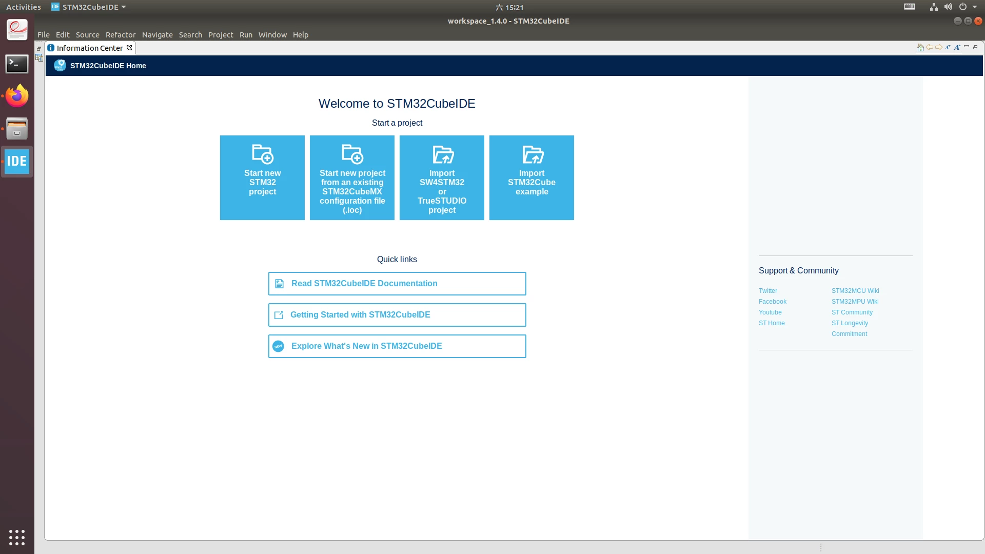

Now, it was ok.
