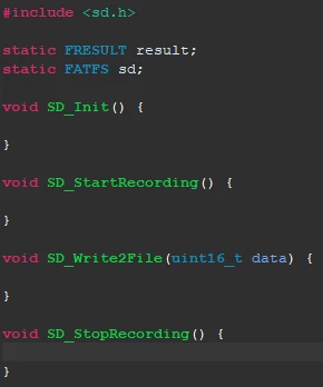

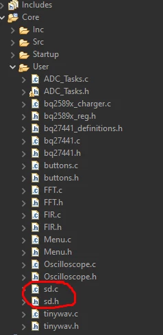

In the code I deleted #include "fatfs.h" line in main.c. After that, I created 2 new files called "sd.c" and "sd.h" in /Core/User folder which i've created.
SD.H file:
#ifndef USER_SD_H_
#define USER_SD_H_
#include "fatfs.h"
#endif /* USER_SD_H_ */
SD.C file:
#include "sd.h"

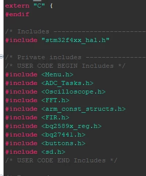

main.h file:
#include "sd.h"
/* USER CODE END Includes */

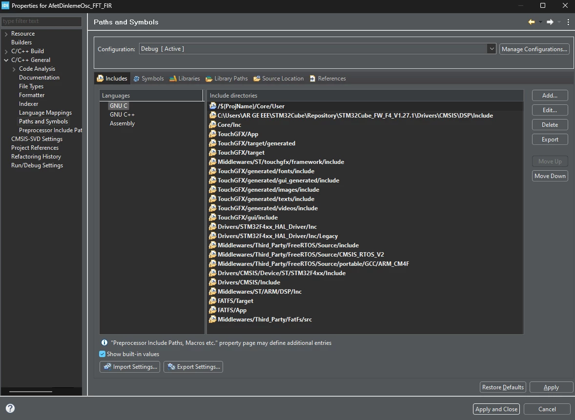

    Hello @ÇSerp.1 ,
    The problem here seems to be related to the configuration of your project.
    Look at the Include Paths settings and make sure that your project has the right include paths and the compiler knows the path to fatfs.h.

    Hello @Imen.D
    I don't see any problems with the include paths. Here are my include paths and files:
    Include paths:
    Files:

    I also get errors if i move #include "fatfs.h" from main.c  to main.h. Normally, when i created the project, "fatfs.h" is already included in main.c. If I don't include "sd.h" file to "main.h" and just move the inclusion of "fatfs.h" from main.c to main.h, i get the same errors.
