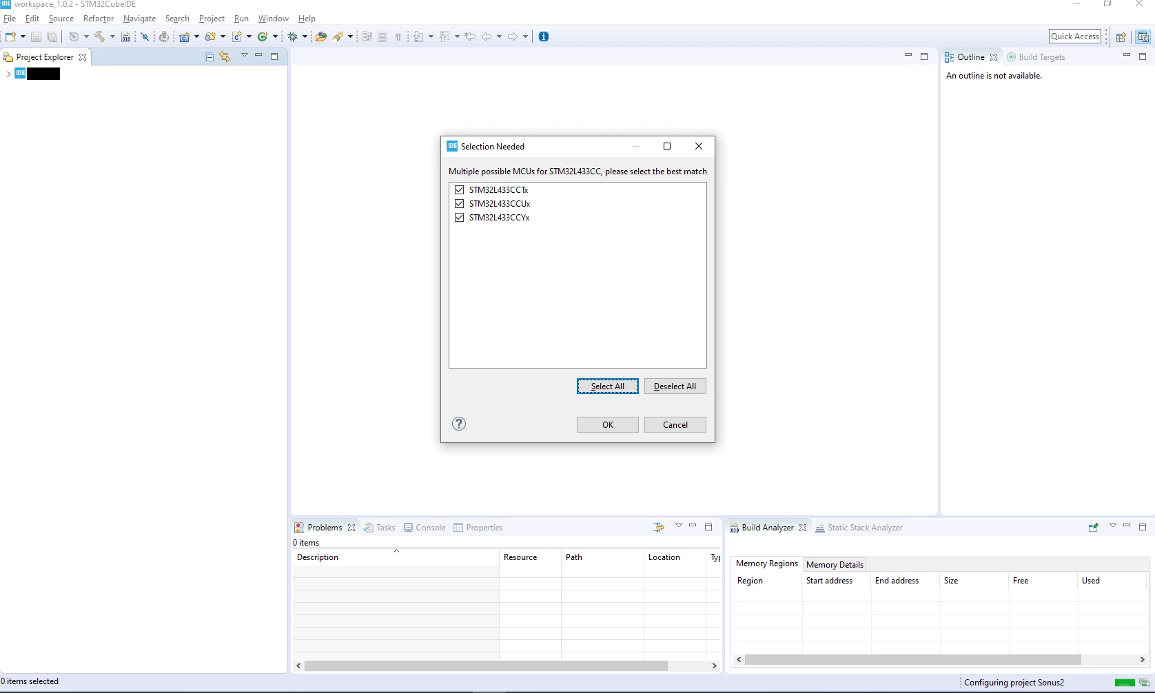

How to import TrueStudio project into STM32CubeIDE properly?
Hello there,
I downloaded the STM32CubeIDE version 1.0.2 and tried to import a project from True Studio following File->Open Projects from File System... and selecting the directorie where my True Studio project is located.
A dialog window opened asking me to select the best match for my MCU. After doing this, the same dialog window appeared again and again. Choosing OK or Cancel options result at the same and I cannot skip this window even using close button. I had to close STM32CubeIDE using the Windows Task Manager.
The MCU I am using is STM32L433CCT6 and my operation system is Windows 10 version 1903.
Could you please help me solving this issue? I have several projects using the same MCU, I tried all of them, but I always had the same result.
