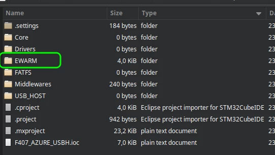

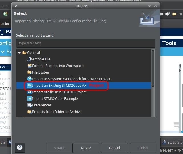

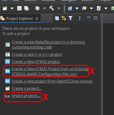

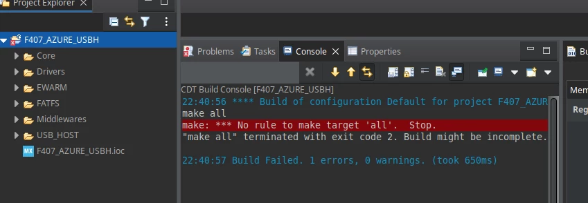

Hi, I tried to create and import through the *.ioc file, but it didn't work. The EWARM folder does not appear along with the other project folders. I tried to generate again with the Device Configuration Tool Code Generator, but it didn't work, even with the RTOS Azure appearing on the screen, the EWARM folder is not created in the project.
It also failed to compile if added as C project, seems to be importing as project with Makefile. I tried to clean the project, but it didn't work.

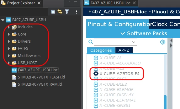

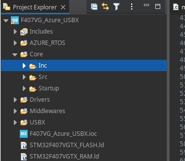

Project generated in CubeMX:
STM32CubeIDE:
Would it be possible to add a way to add the projects generated by CubeMX without having to rework anything, since they use the same database (FW_F4)?

    KnarfB
    June 24, 2023

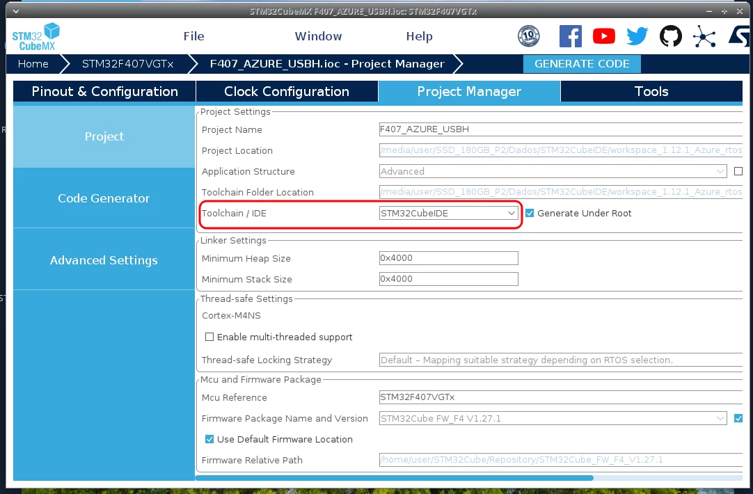

    EWARM is another IDE, not STM32CubeIDE. Did you set STM32CubeIDE in the STM32CubeMX Project Manager tab before exporting?

    So it could be a bug, apparently STM32CubeIDE is pre-selected,
    But since it's the first time I'm generating a STM32CubeIDE project through STM32CubeMX, which I consider a step backwards, so I hadn't paid attention to that.
    I'll try to generate new project codes for these different toolchain options to see how they turn out.

    After having selected another toolchain different from the STM32CubeIDE, the next times the STM32CubeIDE toolchain was selected, the STM32CubeMX generated the project codes without the EWARM folder.

    As @KnarfB wrote, the EWARM folder is for a different IDE (which you probably don't have, else you would know). So there's no any problem, except some user forget to choose correct options.

    I'm trying to use rtos Azure, I couldn't make the "Device Configuration Tool Code Generator" from STM32CubeIDE generate the code with rtos, if using the Generator it removes the RTOS.
    When I search for Azure rtos, I get an example of using the H7, and in a video it says that the Azure package is compatible with STM32CubeMX, that's why this madness.

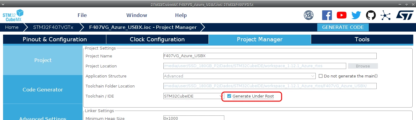

    Regarding project import, I recommend that whoever is going to create the project leave the "Generate Under Root" option checked, although CubeMX warns about possible conflicts.
    This causes the project not to be created nested in the project folder. If this option is not checked, STM32CubeIDE will import the files from the Root folder as a reference, even the Inc folders are not in the accessible file tree, only the *.c (Src) files are available.

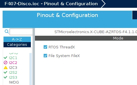

    AScha.3
    June 24, 2023
    download and tried for F4 :
    - F303 : not possible (grey)
    -F407 : possible, can check
    so - depends on chip... on F407 discovery - ok.
