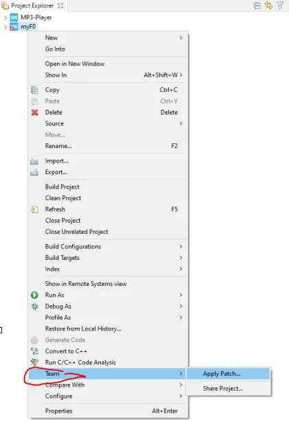

Hello all,
I have received a .patch file (modification) for a SourceCode. How do I import this file directly to my SourceCode without manually changing the line changes described in it in the SourceCode. Is there a way to simply import this .patch file and the adjustment happens automatically?
Thanks for your feedback.
Cartu38 OpenDev
Cartu38 OpenDevBest answer
Graduate II
December 21, 2020

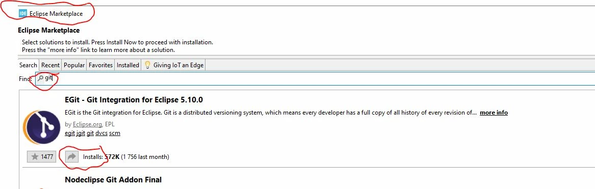

Both proposal here.
Either rely on a terminal and play with common git batch commands (git amend <patch file>).
Or add integrated git support to STM32CubeIDE relying on Eclipse market place (Help>Eclipse Market Place)
Some new project contextual menu so called "Team" is then available to you allowing full GIT management

The native way is applying the patch command from a (linux) command line.

AFido.1
AFido.1Author
December 21, 2020
Thank you very much Cartu38 OpenDev. It works perfectly!
