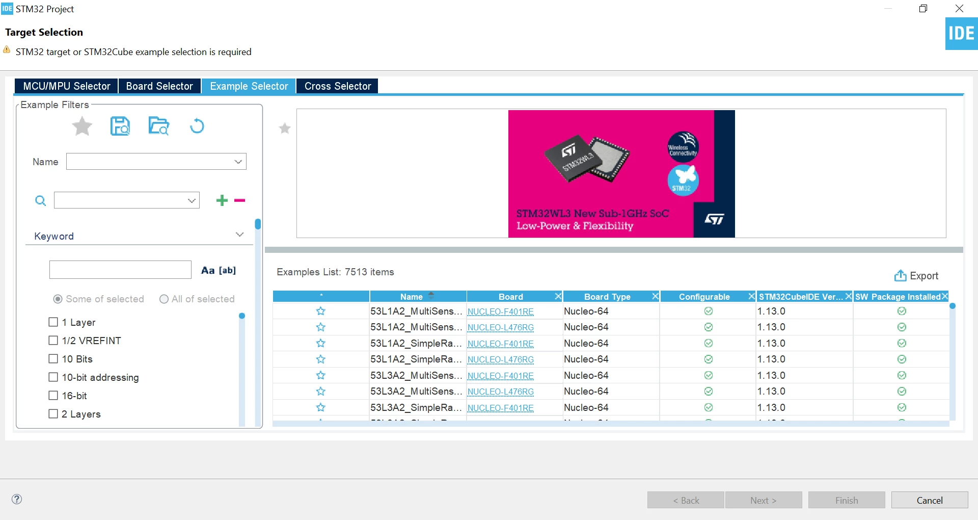

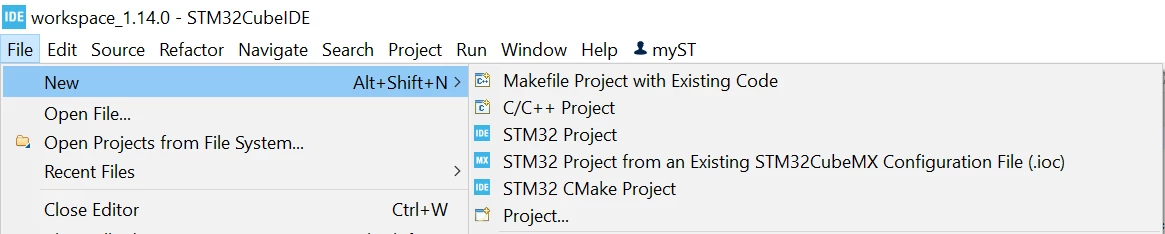

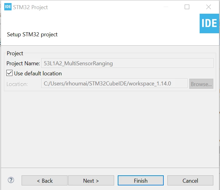

how to get the sample programs
how to get the sample programs in stm32 cube ide

To find the sample programs using the STM32CubeIDE, you should select File > New > STM32 Project:
Then, go to the Example selector:
Select the example you are locking for and click on next then finish (after choosing Name and location if you want):
