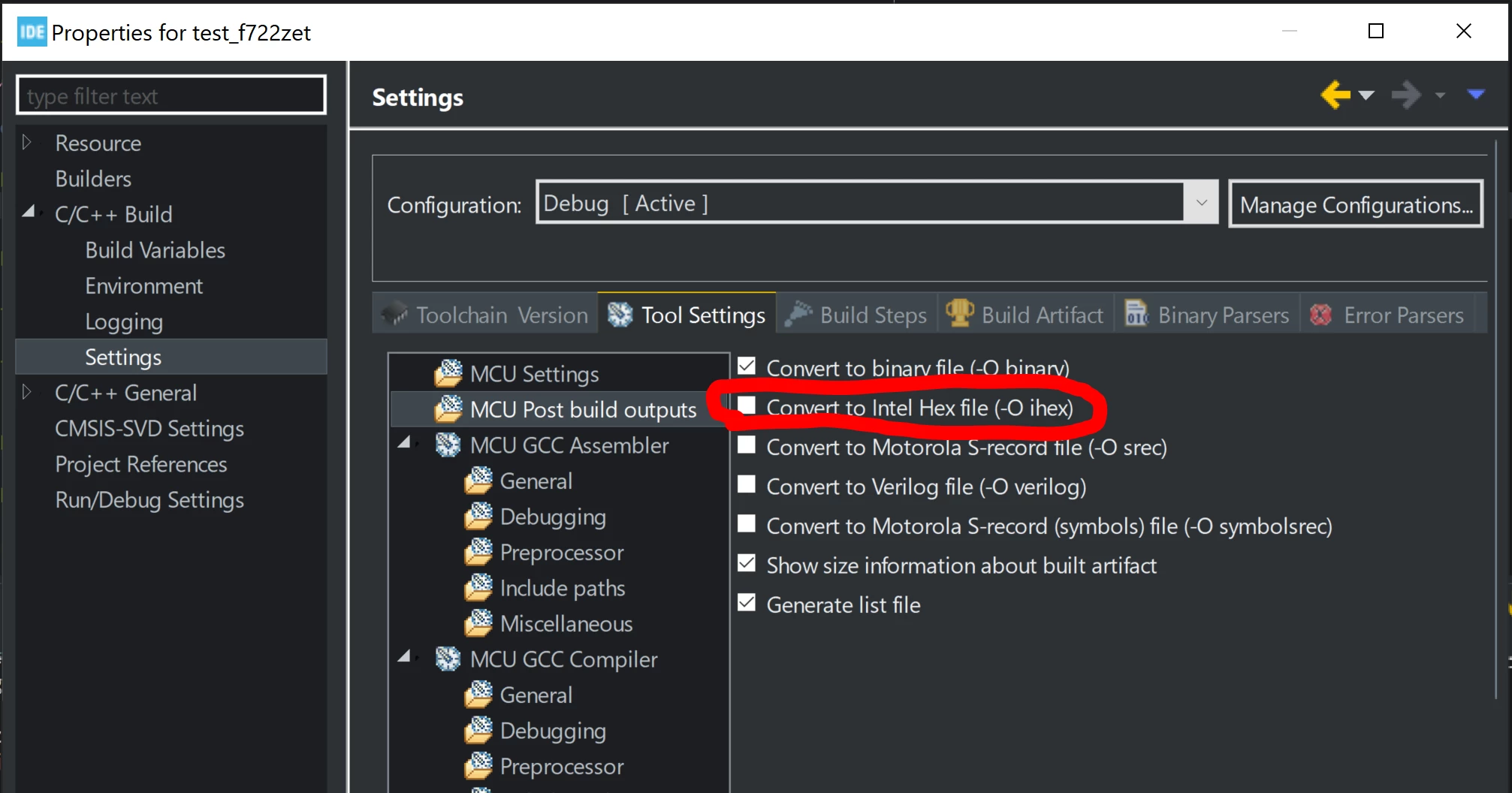

how to get an HEX file instead of an ELF

CubeIDE tutorial ?
objcopy ?

Cube irrelevant. How to force the builder to generate an HEX file instead of of ELF?
Dec 10, 2020 1:52 PM UTC
Mark the checkbox in MCU Post Build Outputs.

Many thanks, problem solved!
