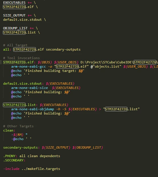

How to generate *.bin file after building with CubeIDE?
0690X000008B9YlQAK.pngHello Cube IDE team
I am using STM32F427ZG MCU board with STM32CubeIDE
But I have trouble to generate *.bin file after building with CubeIDE.
I think it support *.elf file only for now.
If below command can be added into makefile, then *.bin file can be generated by CubeIDE
arm-none-eabi-objcopy -O binary STM32F427ZG.elf STM32F427ZG.bin
I modified this file to generate *.bin file but every time building the IDE project, makefile was re-generated automatically by IDE so i couldn't test it.
Could you update it to generate *.bin or *.hex file?

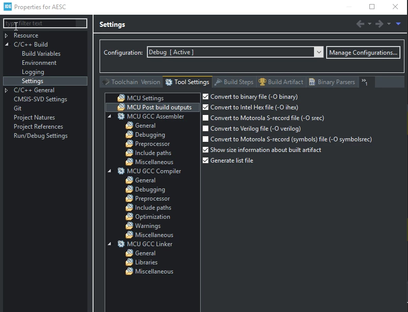

Go to project properties: C/C++ Bulild->Settings->Tool Settings->MCU Post Build outputs

After selecting "Convert to binary file" and "Convert to Hex file" option in the Tool Settings, *.bin and *.hex files are generated successfully.

Problem: I had the same issue and tried the above solution, however C/C++ Bulild->Settings->Tool Settings does not show an option '->MCU Post Build outputs' so I cannot select the Conversions as shown above. (See screen shot)
How to make the ->MCU Post Build outputs option appear in the first place?

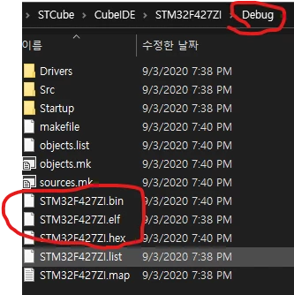

CARHERO
CARHEROAuthor
Sep 3, 2020 10:45 AM UTC
0693W000003QfL4QAK.pngI tested it with v1.4.2 and got the *.hex and *.bin correctly.
You should get the below console log like below if *.hex and *.bin file is selected to be generated
19:40:48 **** Incremental Build of configuration Debug for project STM32F427ZI ****
make -j8 all
arm-none-eabi-size  STM32F427ZI.elf
arm-none-eabi-objcopy -O ihex STM32F427ZI.elf "STM32F427ZI.hex"
arm-none-eabi-objcopy -O binary STM32F427ZI.elf "STM32F427ZI.bin"
  text  data  bss  dec  hex filename
  7128  112 12336 19576  4c78 STM32F427ZI.elf
Finished building: default.size.stdout
Finished building: STM32F427ZI.hex
Finished building: STM32F427ZI.bin
19:40:49 Build Finished. 0 errors, 0 warnings. (took 1s.2ms)
