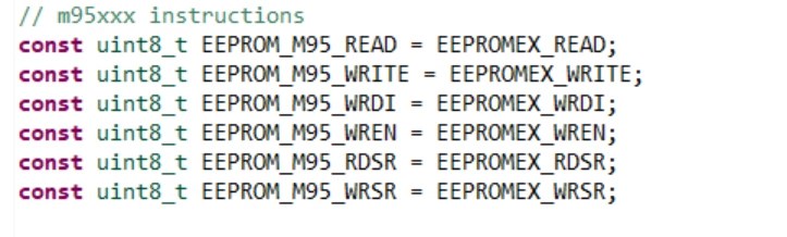

How to fix vanishing/wrong tab/tabs titles in STM32CubeIDE Version: 1.12.1
STM32CubeIDE Version: 1.12.1 Build: 16088_20230420_1057 (UTC)
OS: Windows 11, v.10.0, x86_64 / win32
Java vendor: Eclipse Adoptium Java runtime version: 11.0.17+8 Java version: 11.0.17
4K Displays
i use the properties / compatibility / change hdpi scaling settings as the icons are not usable/unscaled when not using hdpi scaling.
i use the system enhanced scaling (system scaling is blurry, see pictures)
when i move the mouse pointer over tab titles they reproducible get blanked (not valid for first tab in a row) or get filled with the title of a next to it tab..
when using the windows sniping tool for a screenshot, first the screen is greyed/darkened. this greying/darkening is removed after area selection. when greying is reverted the tab titles get refreshed -> can not screenshot that behaviour.
this occures new with 1.12.1
PS
adding
-Dswt.enable.autoScale=true
-Dswt.autoScale=175
-Dswt.autoScale.method=nearest
to "path:\ to \STM32CubeIDE_1.11.0\STM32CubeIDE\stm32cubeide.ini"
and deactivating the window application hdpi config seems to be usable for now.
