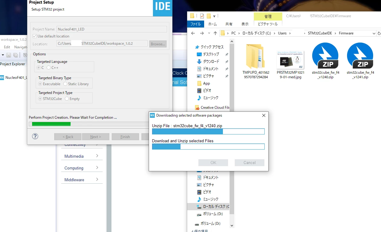

I succeeded in the following way.
1) Preference > STM32Cube > Firmware Updater
Change "Firmware installation repository"​ to C:\Users\***\STM32CubeIDE\Firmware .
(note : create a new "Firmware" folder under the STM32CubeIDE)
2) Puts the mirrored zip file (stm32cube_fw_f4_v1240.zip and stm32cube_fw_f4_v1241.zip) in "Firmware" folder.
3) When you create a project with the Nucreo F401 board (example) from the Start new STM32 project, zip decompression will start.
