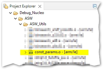

KierAuthor
July 1, 2024
Thank you.
Yes the file exists albeit in sub folder.
This got me thinking that I need to qualify the object filename with a relative path:
 .cal_data :
 ./ASW/ASW_Utils/const_params.o(.rodata)
 } > FLASH
Now the linker completes its .elf output without error. However, the cal_data output section still does not appear.

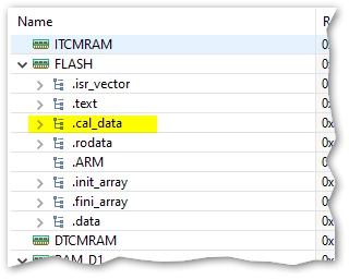

Next, I noticed there's an apparent duplication of most input section names in a typical .ld file, e.g. .data and .data*
Following the hint, I added a wildcard to .rodata even though there's no basis for doing so since the target section name (.rodata) in unambiguous.
 .cal_data :
 ./ASW/ASW_Utils/const_params.o(.rodata*)
 } > FLASH
Fortunately this now triggers the correct result:

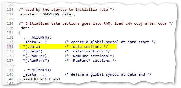

The implication is that only a wildcard for the input section is effective and indeed that is born out by experiment. For example, commenting out line 134 here does precisely nothing:
So this begs the question why the wildcard for the input section name is mandatory or, put another way, when would the line on 134 above be effective? I guess it's not critical, just curious.
