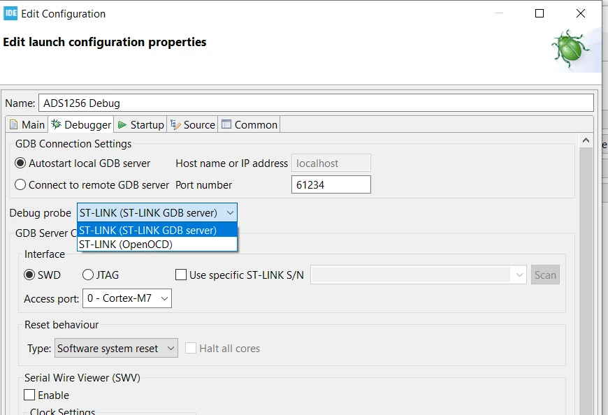

How to enable Segger debugger in STM32CubeIDE v1.1.0
I created STM IDE project from the scratch. I'm using STM32H742Zi Nucleo board.
When I configure the debugger I have only two options , all to them are ST-LINK debugger. See attached picture.
This features worked flawlessly in Atollic True Studio.
The project is available on github
https://github.com/mirtcho/ADS1256
Thanks in advance

Markus GIRDLAND
Jan 7, 2020 11:58 AM UTC
Since J-Link doesn't work with dual core (at least not for 1.1.0) it was filtered out. It's fixed in the next version which should be out very soon.

Cartu38 OpenDev
Graduate II
Jan 10, 2020 8:52 AM UTC
Sounds STM32CubeIDE 1.2.0 is solving such issue !
MMagl
MMaglAuthorBest answer
Jan 10, 2020 9:51 AM UTC
I can confirm that STM32CubeIDE 1.2.0 solves this issue.
The thread can be closed.
