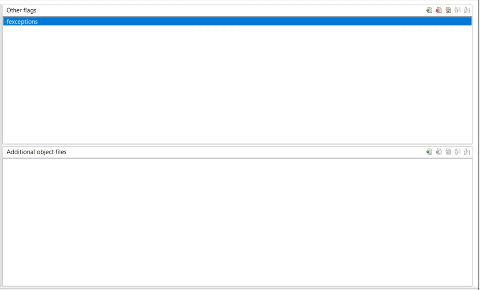

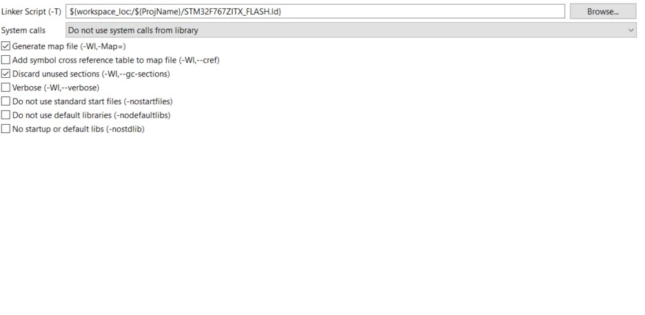

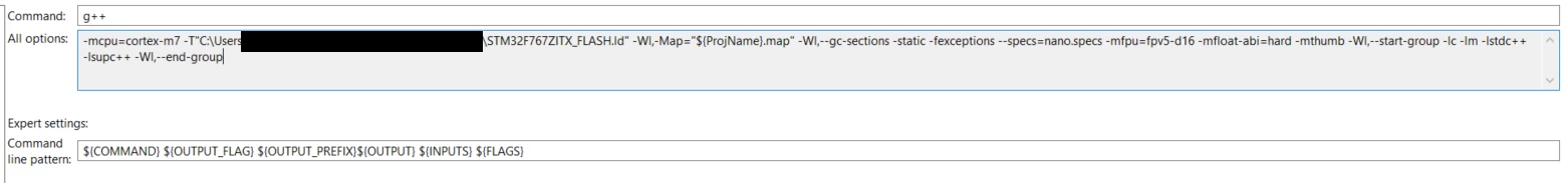

How to enable exceptions (including deleting --specs = nano.specs) in CubeIDE?
I added an -fexceptions flag to the linker script using the Properties menu, but can't find how to remove --specs=nano.specs from the script
Properties->C/C++ Build->MCU G++ Linker
0693W00000Hp4kXQAR.pngThe "All options" is grayed out so I can't edit it.
Properties->C/C++ Build->MCU G++ Linker->General
Properties->C/C++ Build->MCU G++ Linker->Miscellaneous

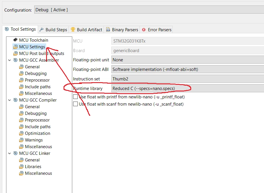

I think this is what you are looking for?

Ah, yes, that's it. I thought it'd be under linker settings, my mistake
