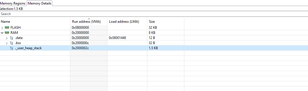

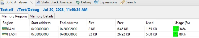

The example project above is basically just declaring global array array_test_global and then later I declare array_test_local
I place breakpoints in various positions and monitoring via Build Analyzer tool:
But I cant see the variables that I declare in the memory.

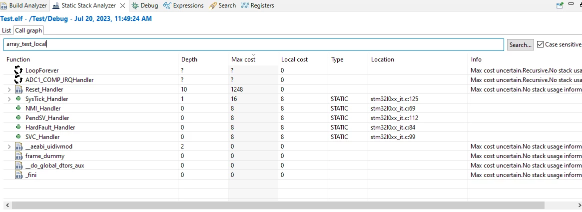

I have also tried to look at Static Stack analyzer but cant see anything usefull there either:
Can someone point me in the right direction and help me understand how to properly monitor stack and heap memory (see which variables are declared in stack memory and their address, also see which variables are declared in heap memory and etc).

    I can add that you can make use of STM32CubeIDE Static Stack Analyzer. Please refer to UM2609 STM32CubeIDE user guide for more details on the way to use it.

    Please see my example project and how I tried to use the static stack analyzer.
    You can see in my example project that I create a few large arrays:
    uint8_t array_test_global[2000] = {0};
    uint8_t array_test_local[1000] = {0};
    but they are not showing up on the static stack analyzer.

    That's probably because your variables are not used in the project and optimized away by the compiler&linker. Make the definitions volatile and/or add some code using the arrays in a nontrivial way, like computing a checksum,...

    I have thought about the fact that maybe this is because I am not using my variables in the project so they are optimized away. That is exactly why I have added:
    array_test_global[4] = 2;
    array_test_local[5] = 10;
    To make sure they are being used. Is that not enough? I would assume at least something should show up in stack analyzer.
    waclawek.jan
    August 1, 2023
    No. The optimizer is smart, so if you never use those variables, it won't create the array.
    Even if you use it in some simple way, it may figure out that the array is not needed.
    Use volatile.
