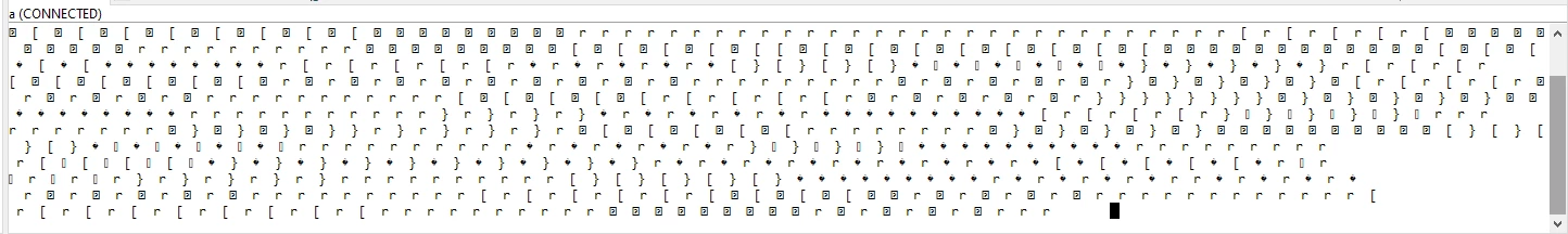

How to display data in the console from the array? Console returns strange signs
Hello :)
I was trying to send some data to the console using USART1 (STM32F7508-DK).
With the following simple data there was no problem:
uint8_t data[] = "HELLO! \r\n";
HAL_UART_Transmit(&huart1, data, sizeof(data), 1000);
But when I try to display values using that code:
uint8_t pData = 0x80;
uint16_t tempData[64];
uint8_t convtempData[128];
while (1)
 /* USER CODE END WHILE */
 /* USER CODE BEGIN 3 */
	 HAL_StatusTypeDef ret = HAL_ERROR;
	 uint8_t ACCEL_ADDR;
	 ACCEL_ADDR = 0xD0;
 ret = HAL_I2C_IsDeviceReady(&hi2c1, ACCEL_ADDR, 1, 100);
	 ret = HAL_I2C_Master_Transmit(&hi2c1, ACCEL_ADDR, &pData, 2, 50);
	 ret = HAL_I2C_Master_Receive(&hi2c1, ACCEL_ADDR | 0x01, convtempData, 128, 150);
	 print_to_console(convtempData);
And print _to_console() function look in that way:
void print_to_console(uint8_t* convtempData)
	uint8_t space[] = " ";
	for(int i = 0; i < sizeof(convtempData); i++)
		HAL_UART_Transmit(&huart1, convtempData[i], sizeof(convtempData[i]), 1000);
		HAL_UART_Transmit(&huart1, space, sizeof(space), 1000);
From console:
Also, it looks like program exits print _to_console() after 4th iteration (i=3) and goes to the int main () to while(1).
Does anyone knows how to solve it?

Data Representation 101
The data in the array is in binary form used by the computer, if you want human readable ASCII decimal characters use sprintf(str,"%d". ..) or itoa()
January 6, 2022
In addition, use strlen instead of sizeof to avoid sending a null character (or more), at the end of each transmission.

@Community member​ @TDK​ Thank you for your answers :) Indeed, I want to have human readable elements in the console.
Could you tell me how the correct syntax looks like?
I tried those 2 options:
	for(int i = 0; i < 128; i++)
		HAL_UART_Transmit(&huart1, itoa(convtempData[i]), strlen(convtempData[i]), 1000);
And:
	char buffer[3] ;
		sprintf(buffer , "%u ",convtempData[i]);
		printf("%s", buffer);
And unfortunately it didn't work :(

It looks like you need to spend some time studying the standard C string handling functions - this is standard C stuff, nothing specifically to do with STM32.
It is far easier to learn basic C skills on a PC or similar "conventional" computer - away from all the added complexities of embedded microcontrollers.
Here are some C learning & reference materials - including a free online textbook:
https://blog.antronics.co.uk/2011/08/08/so-youre-thinking-of-starting-with-c/
HAL_UART_Transmit( &huart1, itoa(convtempData[i]), strlen(convtempData[i]), 1000 );
Check the definition of itoa: eg, https://www.cplusplus.com/reference/cstdlib/itoa/ - you have to tell it where to store the string.
It's the length of that string that you need to tell HAL_UART_Transmit
strlen(convtempData[i]) won't work because convtempData[i] is not a string.
