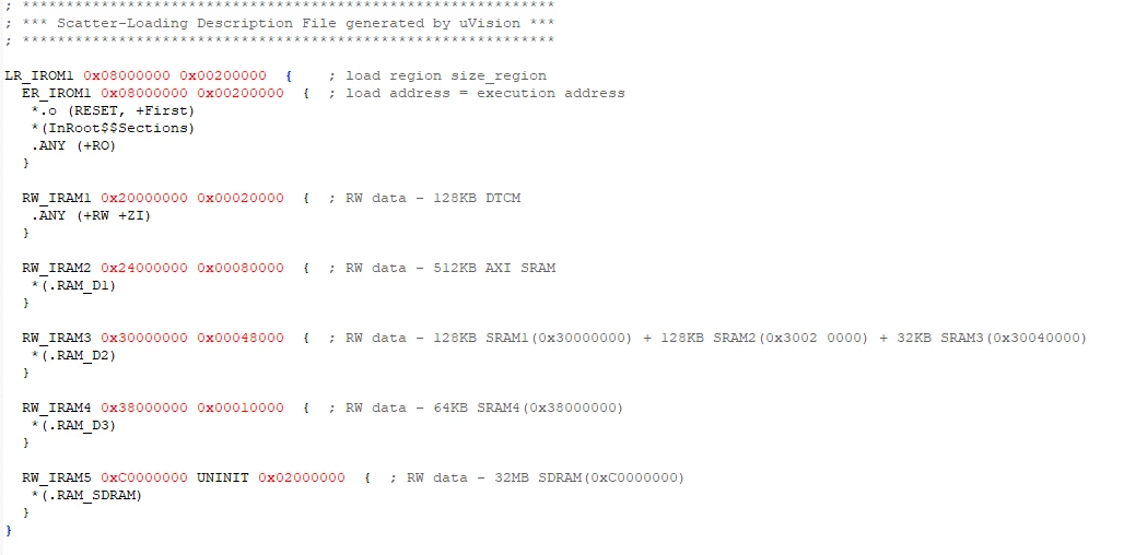

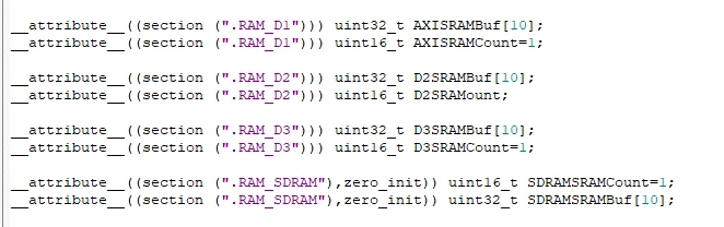

I want to define global variables with initial values in different RAM regions (e.g., RAM_D1, RAM_D2) using STM32CubeIDE for STM32H743.
In Keil, I can usually achieve this by modifying the SCT file as shown in the diagram below.
However, simply adding a section in the LD file does not ensure that variables will have initial values.
So how can I, like in Keil, achieve the definition of global variables with initial values in different RAM regions of STM32H743 using a simple method such as __attribute__ in the code or any other straightforward approach?

The most simple and quick way, with least headache, is to rewrite your static initializers to runtime code.
Otherwise you need to fumble with asm code or something even more terrible in C. Just write something like:
__attribute_((section(".RAM_D1")) uint32_t AXISRAMBUF[10];
__attribute_((section(".RAM_D1")) uint16_t AXISRAMCount;
void init()
 extern char start_RAM_D1[], char end_RAM_D1[];
 memset(start_RAM_D1, 0, end_RAM_D1 - start_RAM_D1); // Zero fill
 AXISRAMCount = 1; // initialize data
Do this for all non-default memory areas. (the default area is where the compiler and linker place the data and bss, and it will be initialized normally).
Exported symbols for  start_RAM_D1, end_RAM_D1 etc. should be defined in the link script (.ld) , around the corresponding memory areas.
Of course it is nice when the compiler & linker do this work for you, that's why Keil MDK costs money ))
