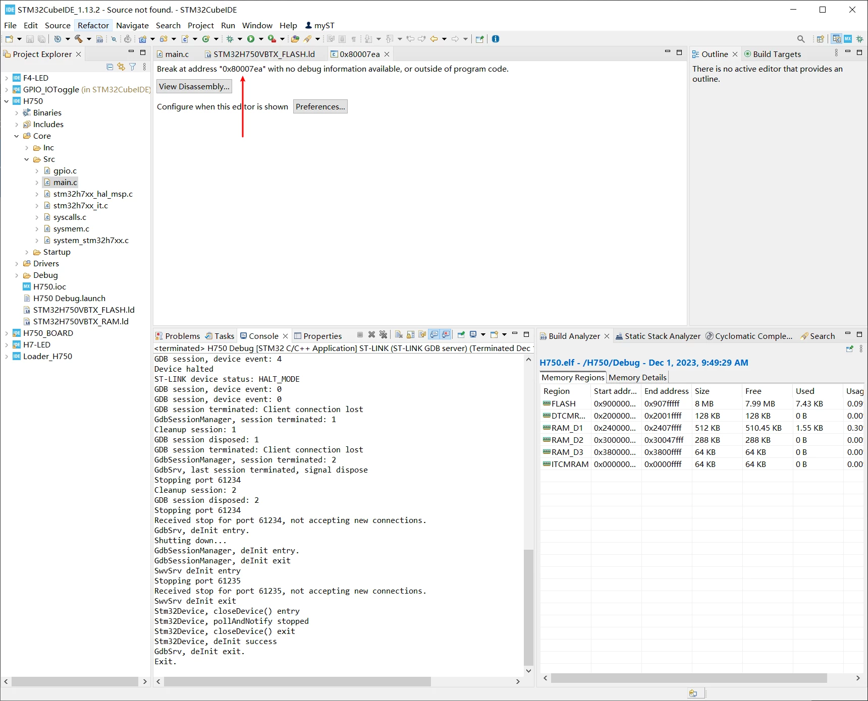

Hi all, I have a STM32H750 board that comes with an external 8MB QSPI Flash.
I've implemented the boot code (128KB Flash internally) and the Flash programming algorithm, I can download the firmware to the 0x90000000 via STM32CubeProgrammer, but I can't debug it via STM32CubeIDE.
The problem in the picture below arises.

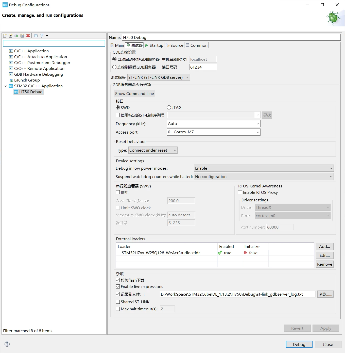

How do I configure the debug configuration of STM32CubeIDE?
The attachment is the whole project.

    Please show your boot code in the internal flash.
    Note, after the boot code configures the clocks, QSPI flash and puts it in memory mapped mode, the code in the external flash should not clobber that. Not to reset the clock, as the default SystemInit does...
    Run the boot code in the debugger (it can load two images at once, or load only debug symbols) and look at the XIP code before jumping there. In debug settings go to Startup tab, set the start address (vector table) to that of the boot code: 0x08000000.

    In other systems you can use debug scripts to bring up external memories or execute code up to a certain point to allow debugger to do its role.
    Perhaps ideally Cube should be able to use the External Loader Init to bring up.
