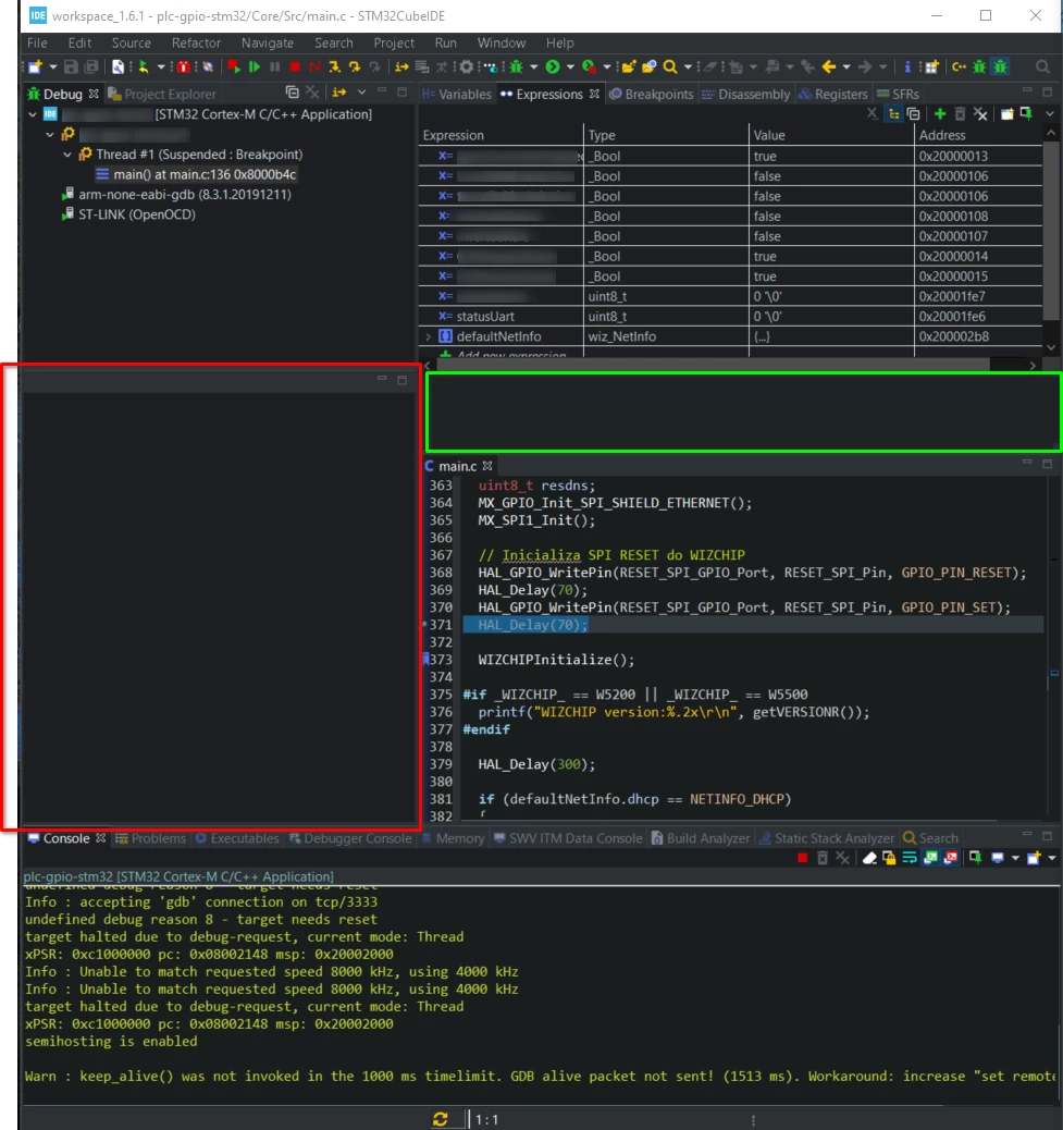

how to customize debug perspective in stm32cubeide?
0693W00000GWowIQAT.pngHi, I would like to customize the debug perspective but I can't remove the selected windows. I want to remove the window with the red box to leave the main.c file in the entire horizontal space, but it is associated with the editor in C ++ perspective. I also want to remove the green box window which is practically useless. I welcome suggestions in this regard.

did you try to manage these view in Window -- > Show View ?

Hi, I did but they are not windows with specific functionalities. They are something like modules/windows of the Debug perspective.
I tried too with Window -> Properties -> Run Debug -> Perspectives ,but when switch of run to debug, the window in the red box load again the .c file

Hi @Juan Gómez​
Seems to be possible with the following steps.
Hope this helps

It works, thanks a lot @Julien D_OEHAUDT​ !!
