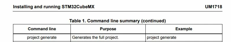

How to create an STM32CubeIDE project programatically from command line ? I know it is possible to use stm32cubeide executable to perform a headless build of an existing project, but I would like to also create a project programatically from command

I'm not aware if STM32CubeIDE. Maybe you can rely on STM32CubeMX generating data setting STM32CubeIDE as outputs target.
Headless project creation is documented if STM32CubeMX. See user guide: https://www.st.com/resource/en/user_manual/dm00104712-stm32cubemx-for-stm32-configuration-and-initialization-c-code-generation-stmicroelectronics.pdf
