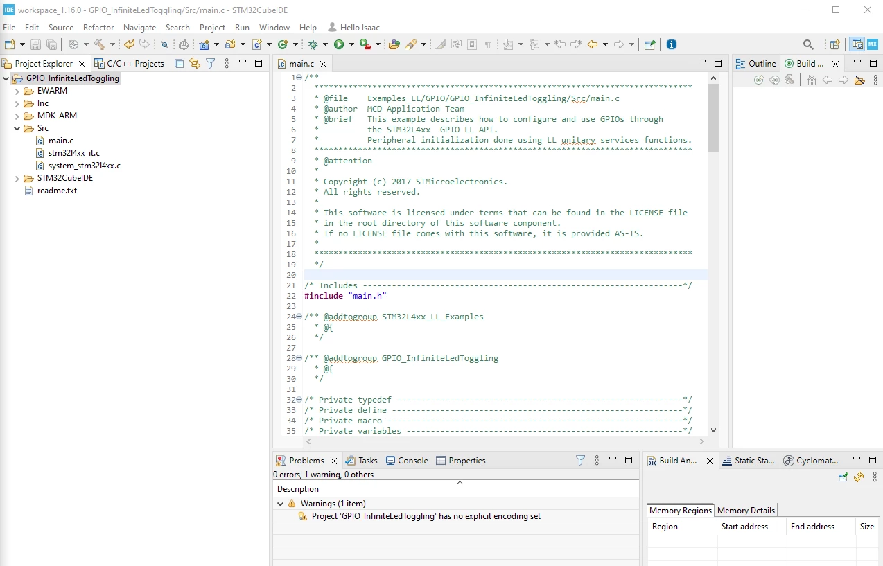

Hi, I am new to STM32 and I have been trying to follow the getting started page and this tutorial. I am having trouble building the project as the option is greyed in Project>Build Project.
I saw in another post (https://community.st.com/t5/stm32cubeide-mcus/the-build-button-is-greyed/td-p/74154), that this could be a result of incorrect project importing but I don't understand how to correct this as I have followed the guide (https://wiki.st.com/stm32mcu/wiki/STM32StepByStep:Step1_Tools_installation).
For reference, I was trying to follow this tutorial as well (https://www.youtube.com/watch?v=BVC7KaUNCS8).
Thank you.

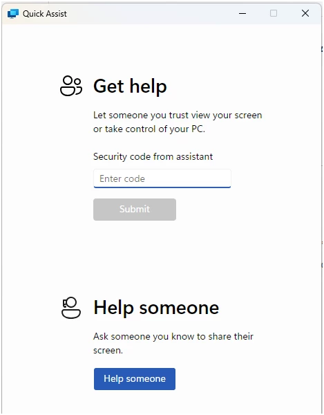

Indeed the first time with CubeIDE may be hard.
From your description, it can be indeed a failed import, or the project files can be corrupted or missing.
For best results, since you are on a Windows PC, try to ask remote assistance from somebody you know,  using the Windows Quick Assist tool.

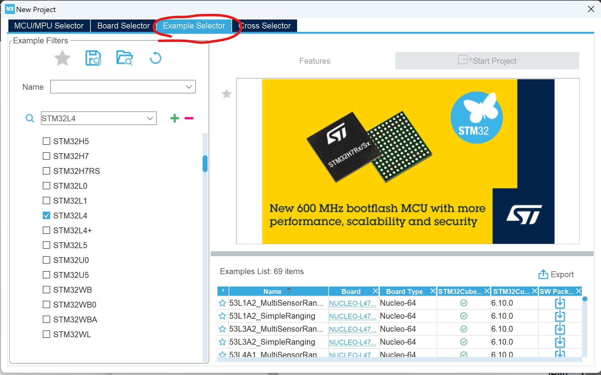

September 7, 2024
You can load examples directly using the Example Selector when starting a new project. Might work better.
