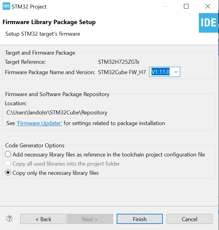

If I understand correctly, the problem is that you are not sure that you are using the right FW package.
If this is the case, you just need to confirm when creating the project that you have used the correct firmware package name and version as shown in the screenshot.
Thanks,
Rim

Thank you for your reply.
Yes, your understanding is correct.
Although it may be too much, we would like to have a prove that the firmware package version that I’m using every time when building the software by using headless-build script in CLI environment.
I’m sure that our project was created with correct firmware package name and version. But if there is a way to double-check it per building the software, that would be helpful for us.
