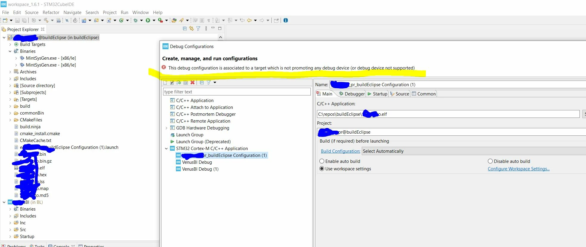

Our project firmware is build using cmake. Cmake is used to create Eclipse project like this
cmake ..\Firmware -G"Eclipse CDT4 - Ninja" -DCMAKE_ECLIPSE_VERSION=4.16
I can import project to CubeIde without proplems and buid it there. Proplem is that CubeIde debugger configuration does seems to accept project as valid project for debuged in stm32.
I have also created bootloader using CubeIde and that I can use for debugging and I have attached Firmware elf to be loaded when BL is debugged. This is workaround to make possible to use CubeIde debugging our firmware.
I attach photo Eclipse error message when configuring debugger
0693W00000BaAcuQAF.jpgHow I should modify our Firmware project so that CubeIde can use it directly to debugging?

Jun 5, 2021 5:00 AM UTC
What does the Debugger and Startup tabs look like?

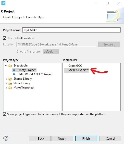

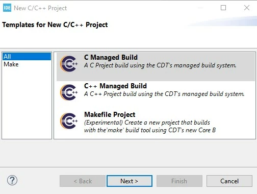

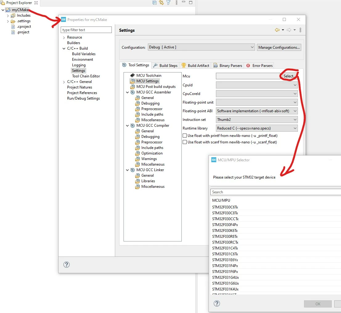

At that time STM32CubeIDE only support STM32Cube debug facilities if you're relying on STM32 toolchain.
Maybe you can mix following setup to your cmake project .... all such is just about project .metadata (i.e. .cproject file content).
0693W00000BaAjvQAF.jpg0693W00000BaAk0QAF.jpg0693W00000BaAk5QAF.jpgHere you're: you have a STM32 target device defined and so full access to STM32Cube debug facilities.
Nobody is forcing you to use CDT managed build setup ... just rely on cmake to build but debug is available to you once your binary file is availabe thru cmake

Thank you both. Thank for tip about .cproject. I try to look what my bootloader .cproject contains and maybe I extend cmake system so that it will modificate firmware.cproject so that it will fill MCU information to there. Maybe that will help debugger to use project.

I tuned some time project files manually and I got strong feeling that debugger configuration is depending on build configuration and that's why I cannot make externally build elf file to be debugged.
My target would be that cmake can generate that kind project files what can be easily build and debug in some Ide.
When big teams work with same project then Eclipse project files are not optimal maintain because those will create bad conflicts in merge. Cmake project files are much easier to handle when multiple people develop.
