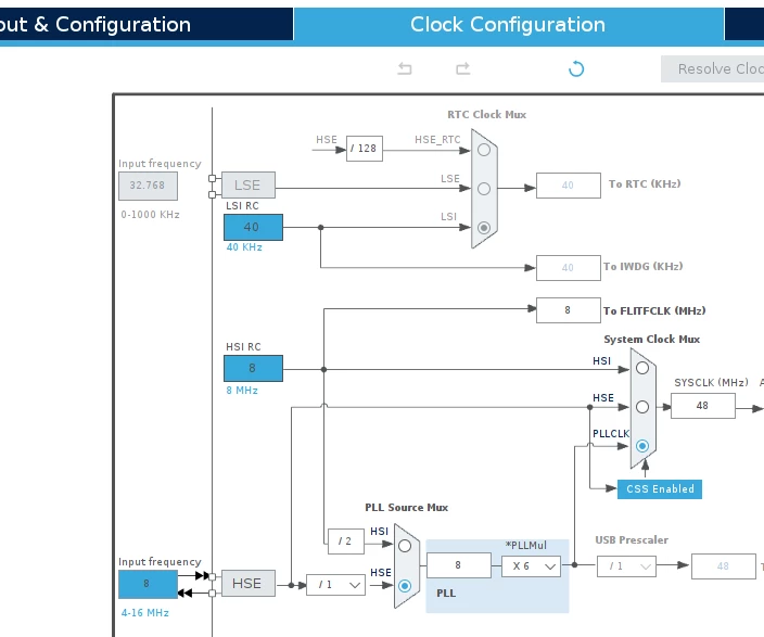

According to the data sheet for this device, I should be able to attached an external High speed crystal instead of using the HSI RC. However, I can't seem to figure out how to do this using the STM32CubeMX utility.

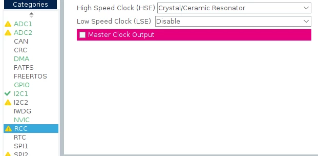

so simple:
  1. set rcc
2 . set frequ.in clock tree and pll
0693W00000Y9S5hQAF.pngok ?
