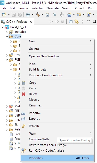

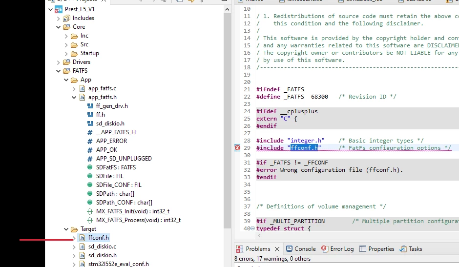

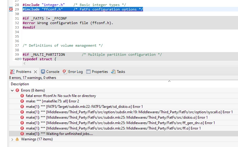

I recover from a project but when I compile there are errors.
And yet this file exists in the project

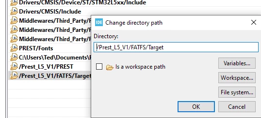

I think that in this tab the configuration is not correct, how can I change the configuration so that it is taken into account in my workspace ?
Thank you for your helps.

That path has a leading slash - you probably don't want that.

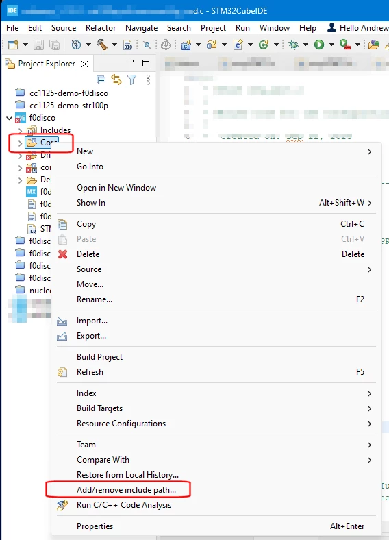

The easiest way to ensure that a folder is correctly included in the Include Paths is to right-click that folder, and choose 'Add/remove include path...'

When compiling there are errors, and the file is configured like this, I haven't modified anything
I'll try this option to see.
