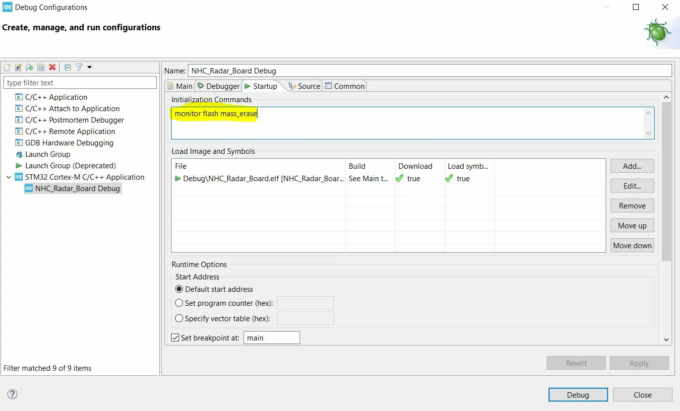

How to clear the total Chip when Reprogramming the MCU; Using STM32CubeIde and a Segger Jlink ;
I use the STM32CubeIde and the Segger J-link program tool.
I've noticed that when reprogramming only the sectors where the program comes are reflashed.
Since I also use other secoters for data storage, would I also want to delete/clear these when reprogramming the mcu?
How can I set the STM32CubeIde environment to erase the entire flash before programming with the segger J link tool (debug/release)?

Ddeve.1
Ddeve.1Author
Nov 6, 2021 5:18 PM UTC

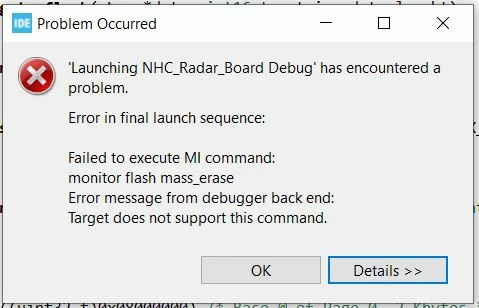

I think this works for a ST link debugger connection ; unfortunately not for a Segger Jlink?!
When adding "monitor flash mass_erase" to the debug configuration -> Initialization statup :
0693W00000GWgKQQA1.jpgI get the following error :
Any suggestions?

Markus Rudolf
Jan 8, 2025 4:55 PM UTC
Try "monitor flash erase" instead. This works for me here with Jlink 8.12 and CubeIDE 1.17.0 (at least when I issue the commands manually)
Markus
