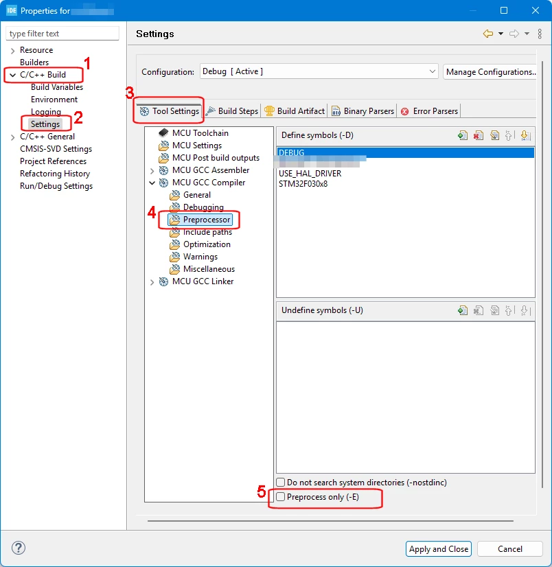

How to check pre-processor output for macro expansion
Is there a way to see how CubeIDE is expanding/pre-processing this code?

Andrew Neil
Andrew NeilBest answer
Mar 31, 2025 9:33 AM UTC
@matt-crc wrote:
Is there a way to see how CubeIDE is expanding/pre-processing this code?.
Note that CubeIDE itself does do the expanding/processing - it's done by the preprocessor during compilation.
But the option you require is here:

matt-crc
matt-crcAuthor
Senior III
Mar 31, 2025 11:22 AM UTC
@Andrew Neil
I originally tried that, but didn't find the pre-processor output.... Eventually, i figured out that the *.o object files contained the expanded C code.  (not obvious)

Andrew Neil
Mar 31, 2025 12:19 PM UTC
The standard command line tells the compile to call its output file .o
So, when the generated output is the preprocessor output, it goes into the .o file.
Indeed, it makes sense once you know - but it's not obvious before you've found out!
There's also the -save-temps option to do the compile and keep the preprocessor output:
https://gcc.gnu.org/onlinedocs/gcc/Developer-Options.html#index-save-temps
